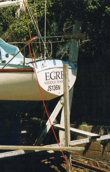

Hi Tom, Yes you can,This is how the original Mk 1's where done ?
Re your thumb ? I guess you won't do that again !

With such a short TH boom, connecting the mainsheet to somewhere near the transom, will mean the mainsheet will "sweep" the cockpit, possibility of getting "swept" OB or thrown against the lifelines (as can happen with my rig if you forget about the lines coming across the cockpit during a tack or gybe.
