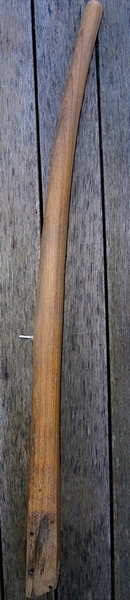

I sanded back the tiller today. It had a crappy half coat of stain and varnish and since I am working on the rudder, may as well do the tiller as well. It is a very light wood, I expected something heavier. Any ideas what type of wood it could be?
I am wondering about just oiling it (will need doing regularly but I like plain oiled wood) or epoxy coating it then a couple of layers of varnish as UV protection (make it stronger). What would you do?

Troppo my dear boy, you have to vanish it ? It will feel so smooth sliding up and down in your hand compared to an oiled one !!
Bear
If you varnish ? it will need at least 8 coats minimum !

If I varnish, I won't stop at 8 coats. The more coats I do, the more insects get caught while drying and the more interesting the effect. And it becomes no slip with all the bumps in it.

I use Sikkens Marine Ceatol on my tiller.
Six coats is fine but I do keep a blue cover on it when not sailing.

I used Cabot's spar varnish, put another couple of coats on each year and cover the tiller with a blue sheath when not in use. Looks good and seems to work fine.

I use International Goldspar and leave it covered, and notice ery little deterioration over time. Once or twice a year a quick rub with sandpaper then one coat and it's done. Adds all of 10 minutes to my varnishing routine.
I think the lesson is that it amost doesn't matter what finish you use, but keeping it covered is vital.

Feast Watson make a very good varnish "Weatherproof " marine grade and you don't pay the marine tax !
I personally don't think you need to use the "spar / gold "type varnishes unless you are actually doing timber masts for obvious reasons . As most of these contain some form of sun protection additives to stop the varnish from breaking down as quickly as other varnishes ,and cost a lot more also .And as we all know you can't put a sock over your mast like you can on your tiller ? I agree with Graeme and keep it covered that's why I keep mine inside the cabin ?
