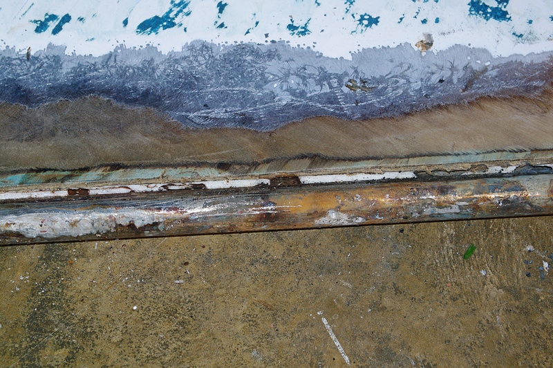

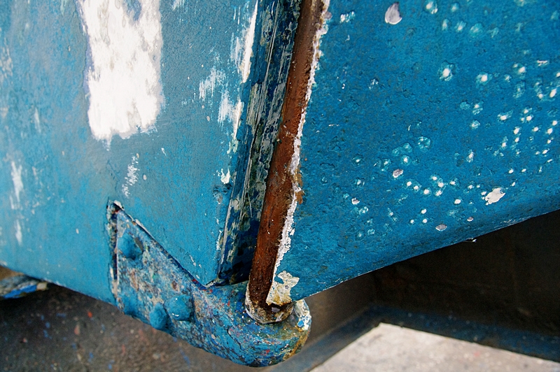

The thin crack along the rudder shaft started to look like a problem when I broke off some of the covering fibreglass. After getting feedback from experts on this forum, I decided I needed to do a repair.
With a chisel I trimmed back more of the fibreglass along the crack. Hmm, not good. Too difficult to do insitu. Rudder needed to come off.

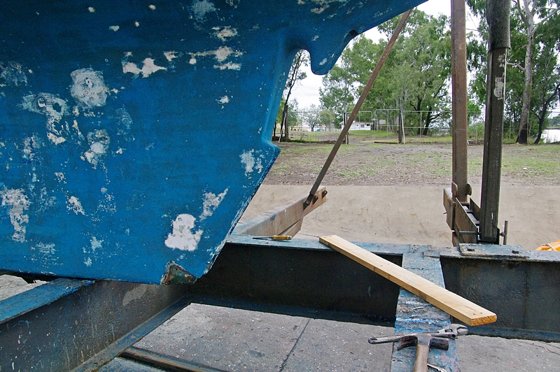

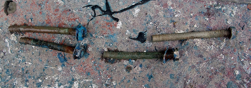

Luckily, there was enough room underneath for the rudder to be dropped down. After shoring up the rudder with some timber, I removed the tiller in the cockpit (easy, undo one bolt and lift off) and found nuts under the layers of paint on the rudder shoe thing. These nuts came off easily, look like copper.
The threaded copper rods came out easily, only needed light taps and then pull them out. Some of them look bent so I am thinking the holes are not straight and could be a pain to put back.

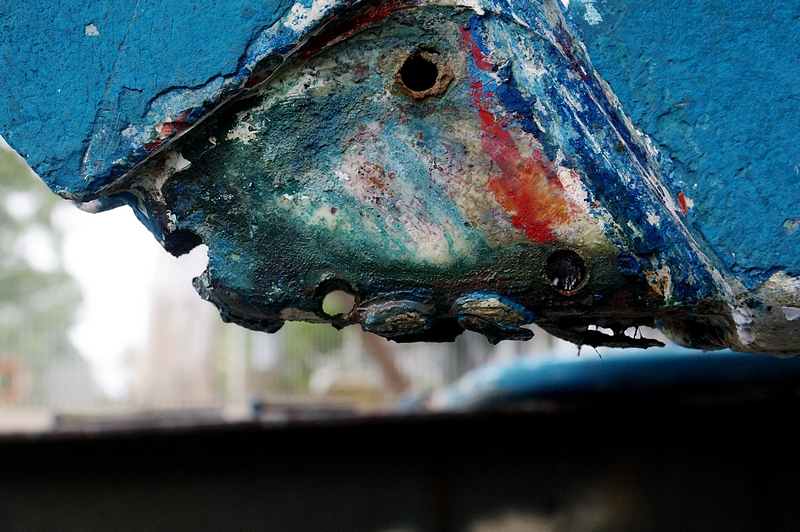

The keel where the shoe bolted on does not look so good. Look at the bolt holes. There were a couple of thin oysters hanging on.
I was concerned the rudder would be too heavy but someone said on this forum that the weight is okay so I moved my supporting planks and lowered the rudder down.

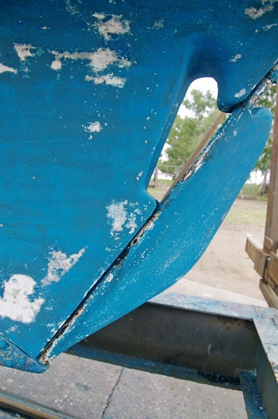

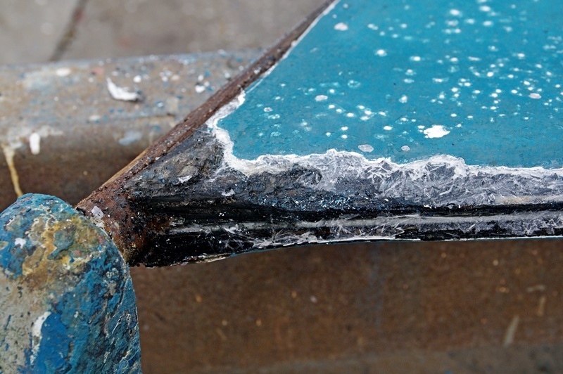

There is a crack running from top to bottom of the tubing and along the bottom. I am seeing a lot of black wood though it seems strong enough, only a small section is a bit soft. I guess there is a fair bit of water absorbed in there.
The good news is that the rudder is still solid. Before taking it off, I had the tiller tied up and I could not move the rudder so the post is not moving in the fibreglass. Don't know why the cracks have happened but it does not appear to be from movement of the post in the rudder. The sea life under the cracked fibreglass in some places indicates to me that the crack had been there for some time.

Postby Phillip » Wed Jun 27, 2012 6:12 pm
Troppo Mate,
You have some work to do. That photo showing where the rudder shoe fits means your rudder is being supported by ONE bolt! No wonder it was bent!
You need to fibreglass that so there is more support. Oysters do not and will not support your rudder.

Okay, thank you for the feedback, I'll build up that bottom section but I'll also grind back the sides of where the shoe fits on the keel and run glass fibre down and under the bottom and back up the other side. That should give some structural support rather than just bog up the bottom area and hope it holds on.

Today I attacked the rudder with the angle grinder. While I knew the bottom edge and that along the rod had cracked, as I ground away, I noticed that there had been new fibreglass run along the back edge and, surprise, surprise, through the clearish epoxy I could see that this edge looked like the other edges with a black layer of ply. Made me think the back edge had cracked some time back and was covered over with new fibreglass but water was still getting in so the other edges cracked.
As I stripped off the fibreglass/epxoxy from the back edge I could see moisture seeping out. Same with the other edges.
Now that I can see much more of the rudder stock, I think it is in reasonable good condition given that water had been getting in. In one corner the ply has delaminated very slightly but overall when feels solid

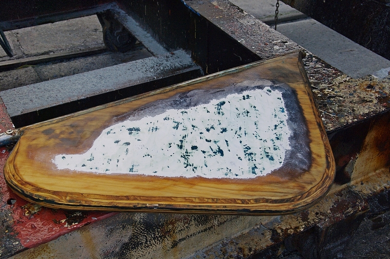

Postby Troppo » Tue Jul 10, 2012 4:17 pm
More work has been done on the rudder.

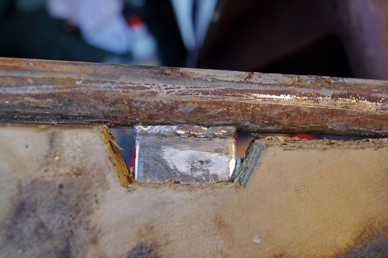

The ss rudder shaft and wood touching the shaft show signs of water even though they were covered with fibreglass. That was the problem I reckon, water seepage.
To seal the wood end grain, I need to be able to get to the end grain. Oh crickey, I guess I need to get out the chisel and angle grinder!

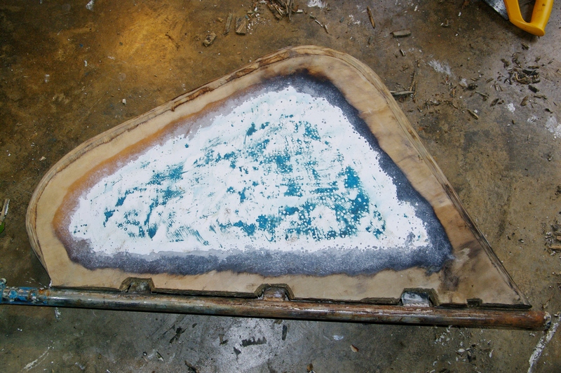

I found a sharp chisel the best tool to cut back the edge of the wood along the shaft. Sharpened it up a few times along the way. Ended up cutting back the ply far enough so that I can easily get sandpaper in between the ply and the shaft. Honestly, I found it very daunting attacking the rudder but I kept thinking if I don't seal the wood I may as well not even bother trying to do a repair. Discovered there were three flanges on the shaft which the ply is attached to. After finding the first flange I needed to put the chisel across the wetstone to get its edge back.
I cut back along the flanges a little to check out what the surface was like. One flange was perfectly clean. The other two started to look cleaner away from the shaft. I reckon they don't need any attention except the exposed metal on the dirty ones will get a polish same as the shaft.
Of course it is raining today seeing as I have to do painting and stuff. Working on the rudder under the house, which is open underneath, I noticed the rudder stock felt damp in places. It occurred to me that since it had salt water in it then there was probably still salt there absorbing moisture from the air. Aghgh, rinsing it would be a good idea otherwise it will just get locked in when I seal it. And then there is the dark water stained ply under the surface resin. While the ply seems solid enough, if I am going to rinse the wood then probably better if I do those surfaces too. Yippeee, out came the grinder.
I have now stripped back the coating over the dark patches of ply, leaving the resin on where it was normal wood colour. The rudder is out in the rain getting rinsed with pure fresh rainwater. It means I will have to dry it out but I have resigned myself it is gunna take a while.
