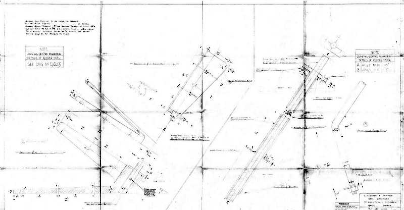

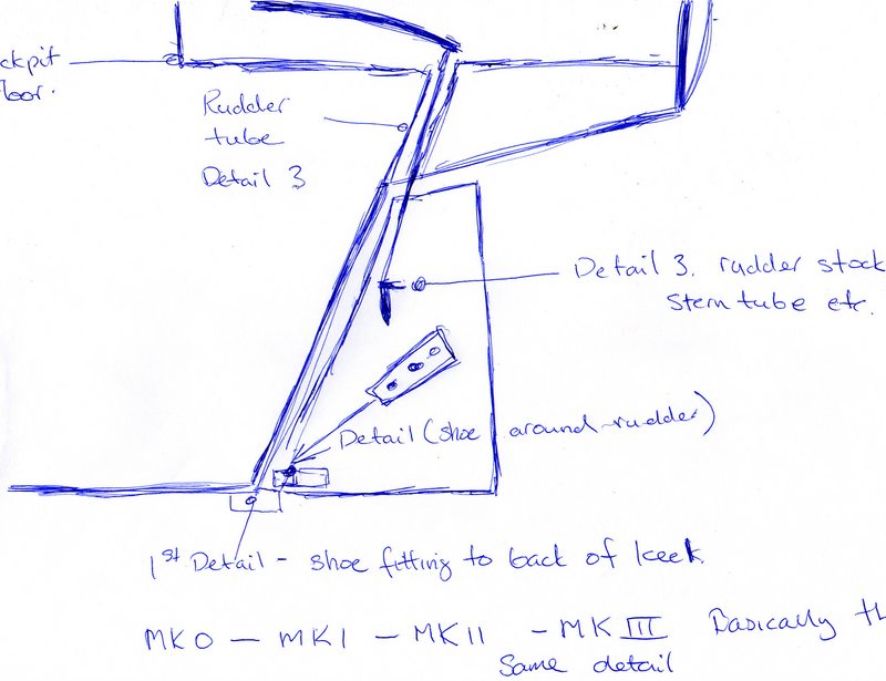

Hi Hatters
Detail for rudder the details are basically the same except for the shoe on the back of the keel is a bracket on these plans

Chris,
I see your point on your "Mark 0".
Maybe it's time to update to a plastic tube if it can be fitted?
