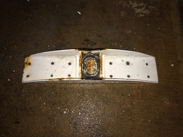

Re: 'Girder' Mast step
Postby Murray Raff » Tue Jun 12, 2018 8:29 pm
Following up replacement of the 'girder' mast step with one in aluminium, do other steel girders have the iron(?) ring in the centre, as seen in these photos? If so, was that an obstacle to the conversion? Kind regards, Murray

Re: Mast step
Postby Phillip » Wed Jun 13, 2018 11:05 pm
That ring is the shoe that fits inside your mast Murray.
It should be of cast aluminium and fits inside the mast to support it at the mast girder.
You should recover it clean and replace.

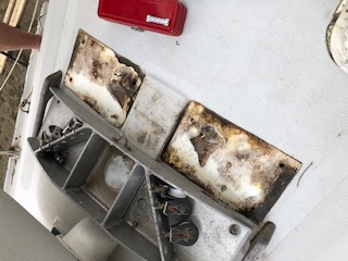

Re: Mast step
Postby Boydie » Sun Aug 05, 2018 7:24 pm
Another idea for the arrangement of blocks on an aluminium mast girder from Ripple Too. May be of interest to some if rebuilding. No real signs of wear from the Becketts and probably 10 years old. Also shows what the Sika Flex underneath looks like after a decade or so.
