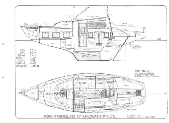

The drawing of the MkII shows the lead finishing before the bilge.
MkI much the same.

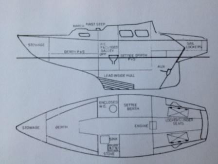

Tales wrote:The drawing of the MkII shows the lead finishing before the bilge.
MkI much the same.
Even in sketch the Mk 1 is perfect .

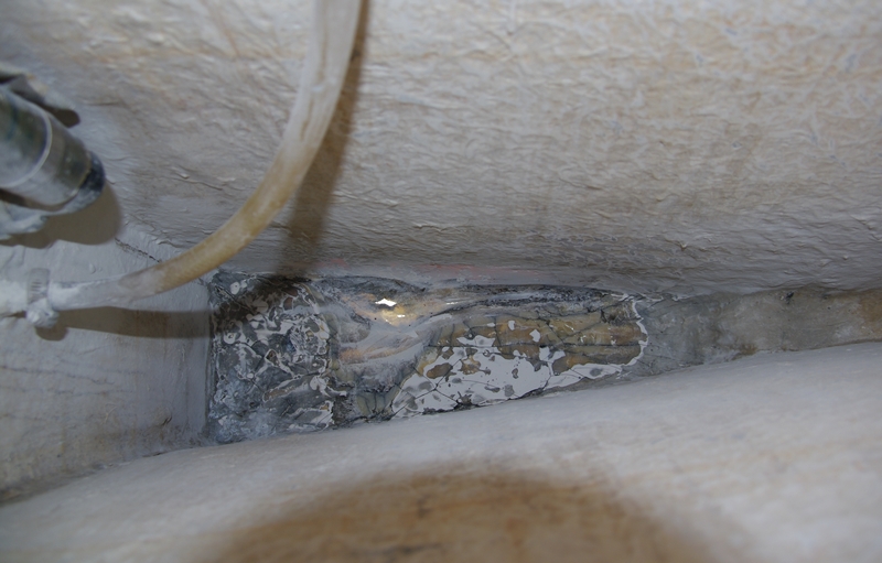

Used chisel and grinder to remove the soft black fibreglass rubbish and some of the covering harder stuff. You can see the hole in the bottom of the bilge, more on that later. In the picture, the area below the hole and a line to the right were the soft areas of mostly black stuff. I did not take any more out as the black stuff was almost gone and the other stuff seemed strong enough to leave.
Bilge after grinding.

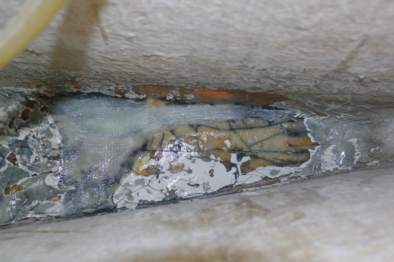

I painted the area with a batch of special runny epoxy to get it to soak into the cracks. A fair bit was sucked into some areas so I reckon it will be all the stronger for it. After laying a dozen or more layers of cloth and epoxy, it was built up but still not quite level.
Fibreglass cloth and epoxy layers in the weak area.

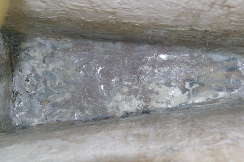

Not finished but stronger than what it was. Last layer of cloth went up the sides and across the bottom. The side which had the cracks on the outside had an extra layer on the inside, so two layers at that point.
Final layer of cloth up sides and across bottom
