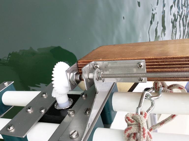

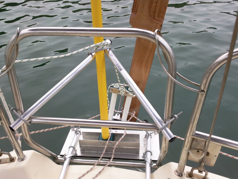

Postby pauldg » Sun Feb 28, 2010 9:57 pm
I recently found a web site that provides a free plan to build a wind vane steering tool.
Since the materials were a bit hard to find, I bought the kit for 300 euros from http://www.mistervee.com
Just finished the assembly and have installed it on my boat. Next step is to step is to test it out and see if it works. Also I have taken some pictures so will post them if anyone is interested.
Cheers, Paul

Postby pauldg » Wed Mar 10, 2010 6:07 am
Hi Peter,
I'll take some pictures and post them to you. The kit cost $600 AUD which I initially thought was expensive but when I got the materials and compared the prices, it is really cheap. The wind vane mast is made of fibre glass, the vane is lexan waver, marineply wood for the rudder, stainless steel for various bits, pendulum is a combination of plastic tube clamps and glassfibre tube, carbon fibre pushrod, formica vane base, glass bearings, nylon crown bevel wheels and various marine 316 steel fittings... I probably have missed a few bits.

Hi Scott,
The installation was not complicated just a few pipes and U clams. I guess an office worker could do it (I'm a Business Analyst but have a degree in electro engineering).
The cheaper alternative is for people who like to experiment (it takes a lot of your time)
Cheers, P
