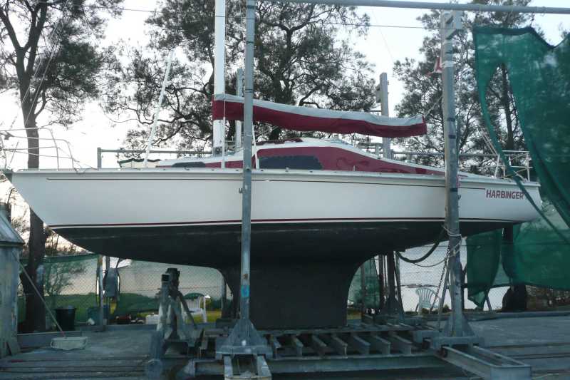

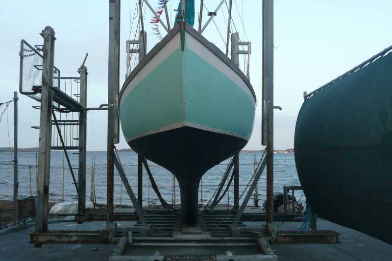

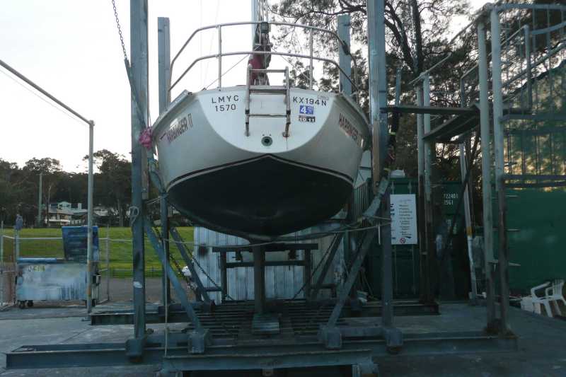

Postby Dolphin » Mon May 21, 2012 11:11 am
You've got to be kidding don't you? I wont use the "C" word that Bear used but they are chalk and cheese!
The Top Hat has a MUCH greater wetted surface area than an Endeavour 26/27.
Its not an ink blot test, but look at the pictures and tell me what you see? They're nothing alike gentlmen. And they sail differently too.
I think I need the white pills to calm down.
Endeavour 26
Top Hat
Endeavour 26 without rudder and prop shaft

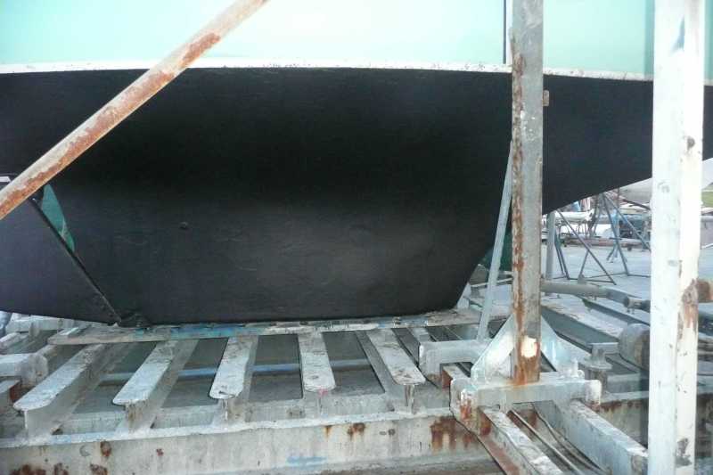

Postby Dolphin » Mon May 21, 2012 11:12 am
And the final one;
Top Hat

If you add the keel hung rudder onto the back of the Endeaver 27 as it is on the Top Hat the Top hat keel is not that much longer, though we all like to think of the Top Hat as a full keel boat in reality it is a long fin keel, The Top Hat was the start of the modern racing yacht.
Illingworth brought out a book called OFFSHORE which he talks about the Top Hat and how he was influenced by another small yacht that he charted and raced for a season, and in her day she was very fast for what she is, she didnt get that fast from having a full keel.
Sure we can split hairs and say the Top Hat keel is longer but not by much and the tophat is in the middle of being a cousin to the full keeler, and just as much a cousin to the older fin keel boats, the rudder on the top hat would be the main difference to the handling giving the tophat more wetted area, the spade rudder giving the Endeavour more of a dinghy feel, after being out in forty kt on Port Phillip bay the Endevour is more than capable of handling big seas with a little 24 sailing part of the way round the world and one i know of sailed from Sydney to Melbourne
