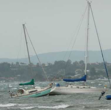

Postby bearmcnally » Tue Jun 05, 2012 7:12 pm
I have Egret II's mooring on Lake Mac every 12 months When she was on Middle Harbour every 18 months or so. The only reason being ,nothing exciting wind wise apart from the westerlies happens in Quakers Hat Bay ,that was my mooring guy's advice . So maybe ask who ever services your mooring he will know?
Again what's $100 or so for peace of mind .It's like an insurance bonus
Bear
