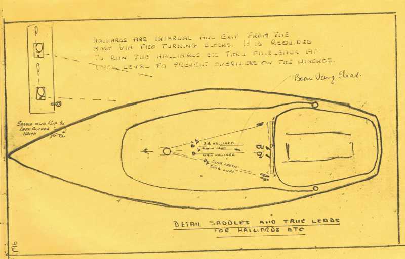

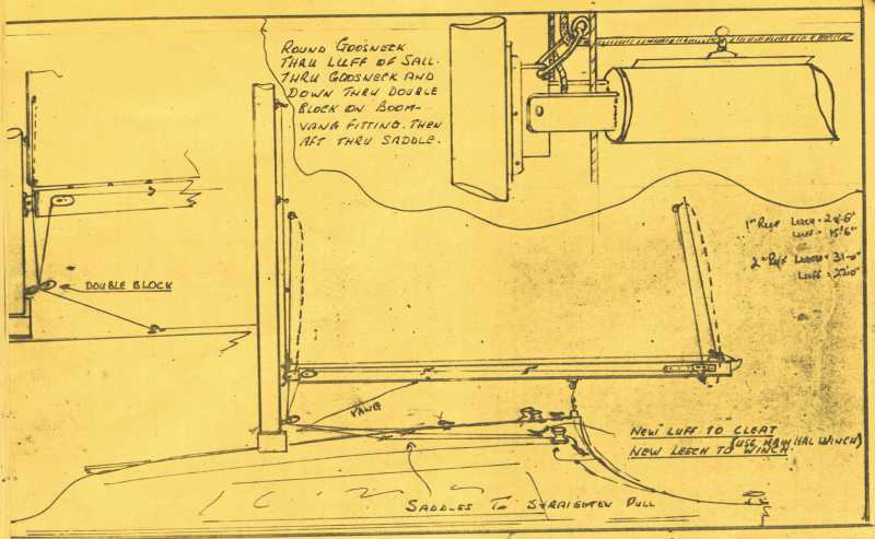

G'Day John Here are some drawings from the 1982 Top Hat Brochure.
I hope it helps. Remember to always only tie the reef points around the foot of the sail NOT AROUND THE BOOM ! If you tie it around the boom and the reef slips it will tear the guts out of the sail.
I had the same problem when I was waiting for a new boom cover. I had it done by a car upholsterer.
BTW its the stitching that fails in the UV not the material.
Tie the clew, the outer part of foot of the sail using a Timber hitch, it is easy to undo and wont jam. Careful how you tie it. On Felicite I have a hook on the goose neck to take the tack.
There should be several people at the sail away that can show you.
Hope it helps.

Kevin, In my desctiption above, I have lines that go from the back end of the boom, where they are fixed, up through the reefing cringle, back down to the boom, then through a block to the front of the boom, through another block, up the luff to the reefing cringle, then back down the mast to yet another block, which leads the lines back to the rear of the coach roof and a cleat. There is a line for each of the first and second reefs. Pretty much as Greg's drawings show above.
To reef, you head to wind, clip on the topping lift, let go the halyard by about a metre, then pull down the reefing line until the reefing points are at the boom. Once the reefing line is cleated off, you haul the halyard back up to re-tension the luff and away you go.
To shake out the reef, all you do is head to wind, let go the reefing line and haul the main halyard up to full height again.
The previous owner told me this system was called a Swedish Reefing set up, but for the life of me I can't find a reference, so it might be something I dreamt. :D Lookng at it, it's really easy to set up and would make it much easier that he rams horn by the sound of it.

Mike the system, is called "Jiffy Reefing". I don't know if you will find a reference to it. you should its common.
Kevin, I have the same system as you, horns on the goose neck. THe more you do it the more you will get used to it and yes reef early. The locking pin should be tied on with something or an "R" pin used on the track in the mast with a lanyard on it.
If you are worried wear a harness. One hand for the ship, and one for yourself.
