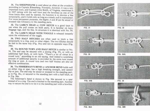

Postby Dolphin » Wed May 23, 2012 10:30 am
G'Day Rod,
Mike good description, may I add, I use the same system, only dfference is I used a fishermans bend which is a little stronger and more secure. The bowline can work loose with vibration and handling.
Another thing I found was that when you use the main halyard to attach to the topping lift on the boom, in winds of about 5kts the line will humm. Sounds like a motor cruiser. If you have a separate topping lift, most have, tie them together with a short length of small stuff 300mm above the shackel to stop the vibration.
On 2 occasions people have thought the bearings in the wind instruments needed replacing. It was the Aoelian vibration.
Another piece of useless information!
Re: Replacing Halyards
Postby Miker » Wed May 23, 2012 10:39 am
Greg, surely you mean an Anchor Hitch? Not a Fisherman's Bend?
Perhaps on June 2 we could have a knot workshop. I only know three, apart from a granny knot......... :shock:

Postby Dolphin » Wed May 23, 2012 7:44 pm
Mike, better study this there wil be questions on it.
Fishermans Bend.jpg (43.25 KiB) Viewed 8709 times
