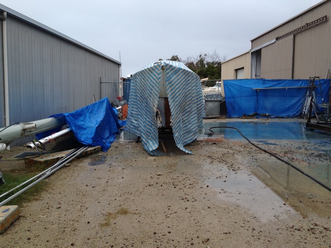

Sundowner with a dress on

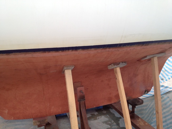

before, about 20 years of paint

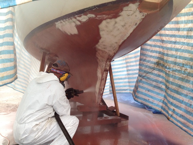

the job begins, all that escapes is water mist.

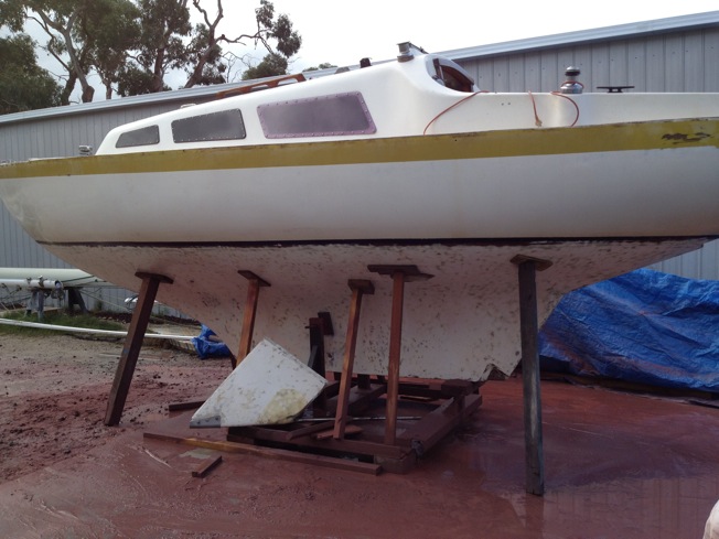

all clean
all clean
