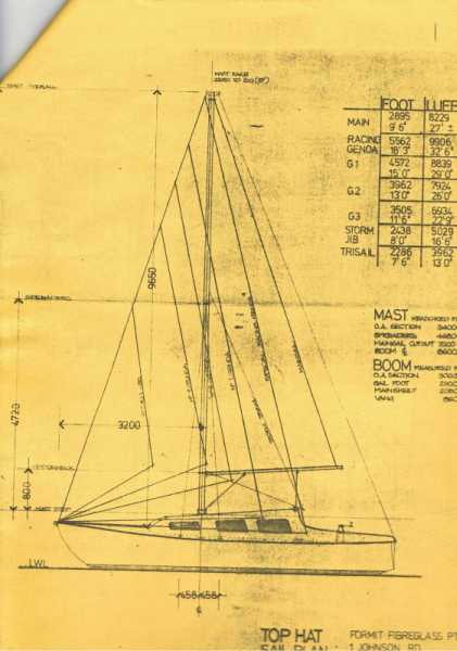

G'Day Phillip and Rod,
Here is the info from the original sales drawings. Straight from the horse's mouth.
Detail at the top of the mast.
Sail Plan Overall
Sail Plana.jpg (23.79 KiB) Viewed 8889 times
Best regards, Greg
Re: mast rake
PostPosted: Thu May 03, 2012 6:32 pm
by storm petrel
Oops, yes I have the original drawing also and it is 0 - 200mm. Don't know what I was thinking with the post above.
Storm Petrel
Re: mast rake
PostPosted: Thu May 03, 2012 6:44 pm
by rob.lovelace
well I had 85mm so I'll give 50mm a go and see how that feels
