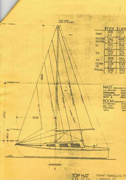

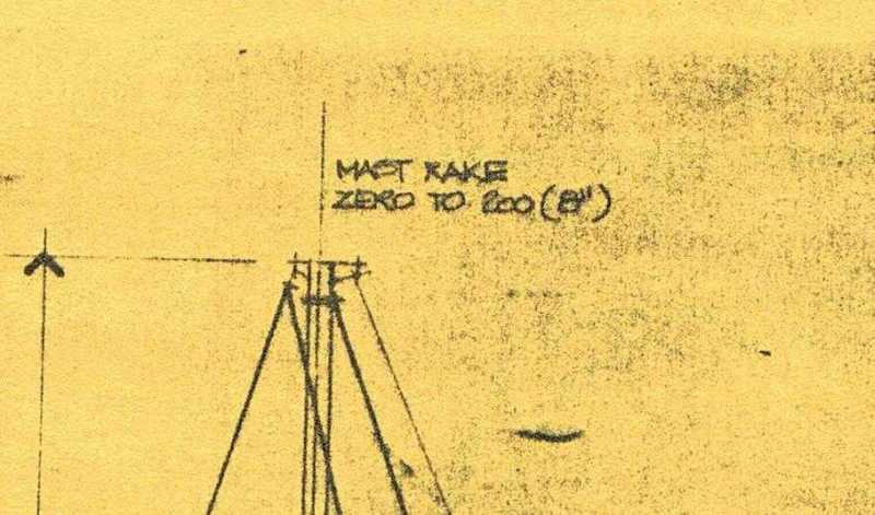

Postby Dolphin » Thu May 03, 2012 12:43 pm
G'Day Phillip and Rod,
Here is the info from the original sales drawings. Straight from the horse's mouth.
Detail at the top of the mast.
Sail Plan Overall
Sail Plana.jpg (23.79 KiB) Viewed 8877 times
Best regards, Greg
Mast Rakea.jpg (43.52 KiB) Viewed 8877 times

Postby storm petrel » Thu May 03, 2012 6:32 pm
Oops, yes I have the original drawing also and it is 0 - 200mm. Don't know what I was thinking with the post above.
