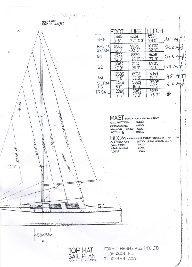

Re: Head sail size
Postby Sean Spence » Fri Feb 03, 2012 6:56 am
While on the subject of head sails, does anyone have the design dimensions for different Top Hat head sails? I have a tiny sail on the furler of my MkIII (I think it's a #3 as there's no overlap). As I'm cruising, and sometimes in light airs, it can get frustrating not having that extra drive. Also spinnaker sizes? I appreciate mast height makes a difference; mine is 9m step to top. thanks! Great discussion to have. :)

Re: Head sail
Postby storm petrel » Fri Feb 03, 2012 3:53 pm
I have attached a copy of the original sail wardrobe that was available for the Mk2 and probably the Mk3. Note these sizes refer to hanked-on head sails, furled head sails might need a slightly shorter leech.
