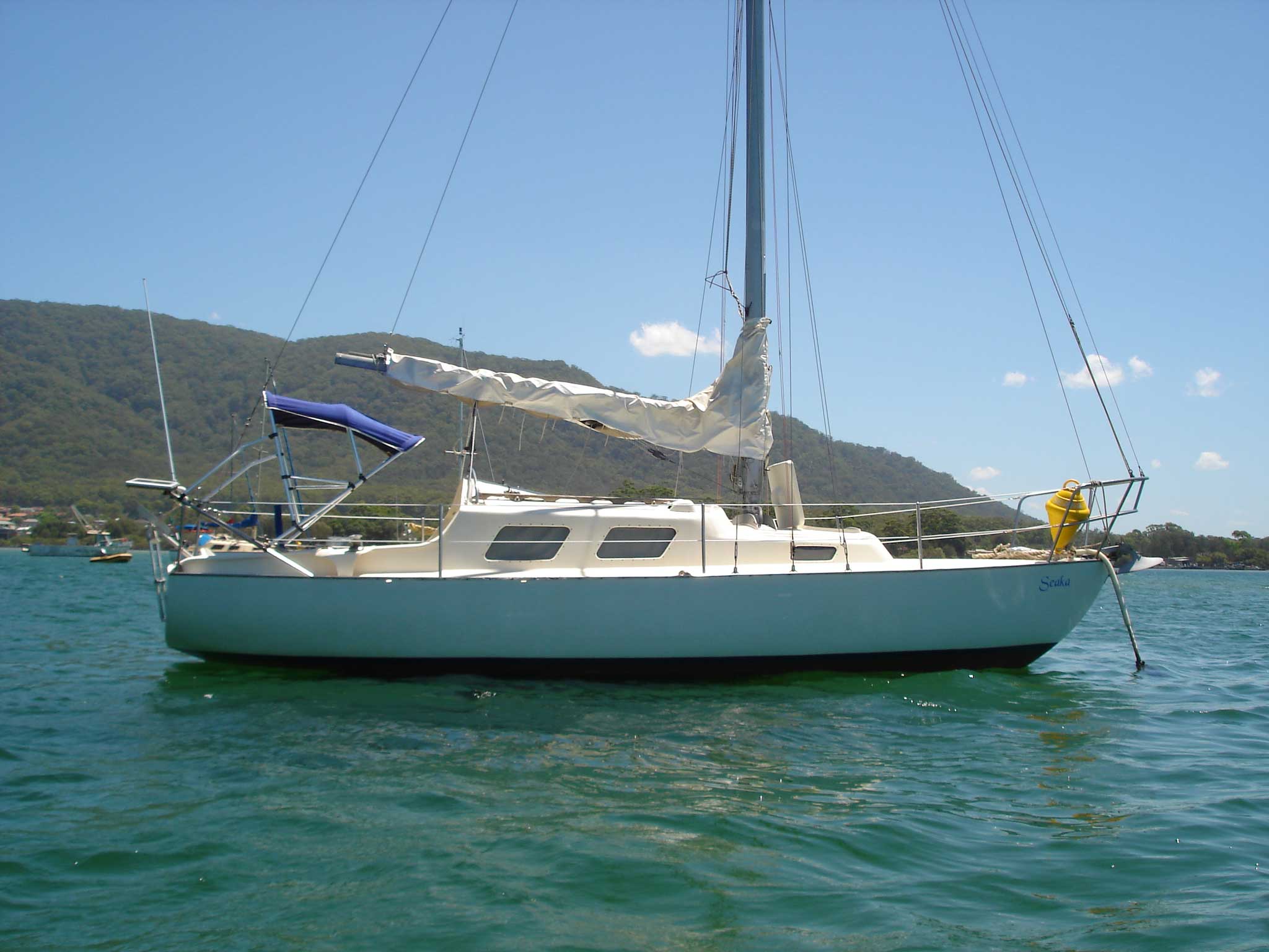

Postby 8philip8 » Mon Nov 21, 2011 8:33 pm
I'd sail with the bimini open.
that was the 1st item I added to "sylph"
being cooked by UV was no fun :oops:
IMG_2324.jpg 30%.jpg (43.96 KiB) Viewed 9187 times

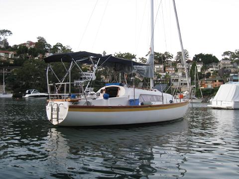

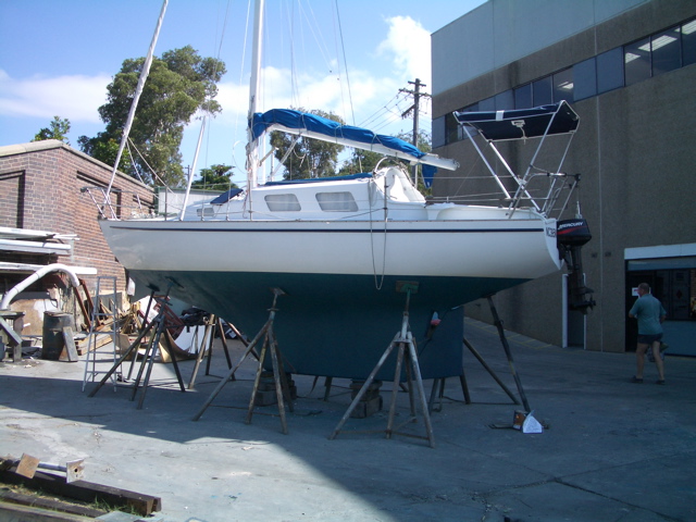

Postby Phillip » Wed Nov 23, 2011 9:50 pm
Gypsea,
I prefer, after a lot of using and experience, to set up my bimini as shown in the photo. Under it, I can stand while helming and still get shade when sitting at anchor or sailing. By slanting the bimini forwards I get max shelter when sailing/motoring into rain [the forward support bow is at my eye level]. When at anchor and its raining I fit a small 2mx2m blue plastic canvass to cover the gap between the bimini and the aft end of the cabin roof [You will always point into the wind], but I have been known to fit the 2mx2m canvass across the back of the bimini to get extra shade from the sun. The only pieces that are not standard in the kits [see Whitworths cat] are the two small horizontal braces which were made up with bits from Whitworths. The height of the middle bow is adjusted when you have the mainsail up so that the boom clears it.
I always sail with the bimini up unless we have 25 knots or more of wind predicted and I always fold the bimini up and put the cover on when I leave SEAKA on my mooring.
Phillip :D :D
Seaka's Bimini
