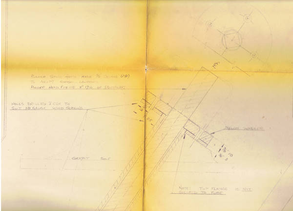

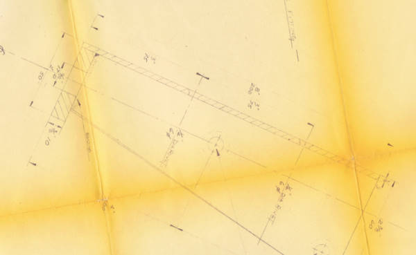

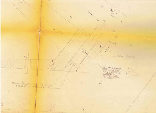

Postby bearmcnally » Fri Jul 22, 2011 10:06 pm
Hi Hatters
Sorry guys the quality isn't that clear ,but the plans are hitting half a century in years ! :o
This might help ! This is basically how Egret II is set-up The only difference is the keel bracket is cast as a shoe,(bottom pic) and I think all MK's are the same ?.
RUDDER FITTING
RUDDER POST /TUBE DETAIL
KEEL BRACKET / SHOE

Postby Killick69 » Sat Jul 23, 2011 3:42 pm
Drawing 1 means next to nought to me. From drawing 2 it seems there should be a bush bolted/screwed to a 'flange' Thickness 10mm and 50mm OD (ID = 17?) and material unknown.
From drawing 3 it looks like there is a mounting (brass?) bolted to the keel and it seems a pintle (rod) screws into it and the distance the pintle protrudes is shown, but unfortunately I can't read the dimension. There is a bush (nylon?) of undecipherable dimensions sitting on this pintle.
The pintle is locked by a pin and I guess if the top of the pintle wears, one can remove the pin, screw the pintle out the appropriate distance and reinsert the pin to lock the pintle. Maybe if the pintle is worn/damaged, too short, one could insert a bolt which has been rounded on the end. Probably stainless steel.
What determines the height of the rudder? is it the bush at the top, the bush at the bottom or the pintle. I guess the bush at the bottom and I guess the pintle is just short of touching the end of the recess in the rudder that it sits in. So if bush wears sufficiently, pintle will become the bearing point. Guess the top bush locates the shaft inside the tube, but does not determine height.
