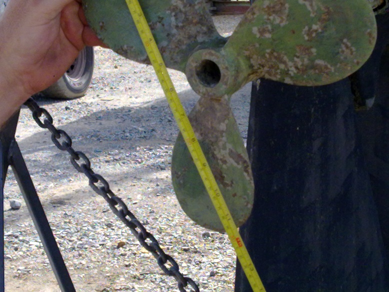

Postby patrol1064 » Thu Jun 09, 2011 7:24 pm
wondering if anyone thinks this is undersized.
patrol1064
Posts: 12
Joined: Sat Mar 26, 2011 8:19 am
Re: prop size
Postby bearmcnally » Thu Jun 09, 2011 8:46 pm
Hi patrol1064
What size /hp is the engine ?
If you clean the back of the prop shaft housing it should have stamped the pitch size and maker etc It looks roughly the size on Egret II I can't remember of hand her size but it's on a BMW d7 (6hp)
Re: prop size
Postby patrol1064 » Fri Jun 10, 2011 5:17 am
hi bear.i thought the sort of standard prop was 13 inch?the engine going in eventually is a 14hp.the boat is on a mooring so i cant get the size,pitch till i get it out the water,rotten winter tides are holding up the proccess.

Postby surrealbass » Fri Jun 10, 2011 9:18 am
I do have the measurement of my prop somewhere but not readily available but I think mine is smaller than yours going by pics- :( was powered by an Arona AD186 which i think was 8-10hp- right now there is just an empty space with a couple of dents in the bilge where my knees fit while I progressively scrape out 40 years of gunge! I am sure the prop guys will have something worked out for your new motor, just a matter if there is enough room to swing the thing- I think they use a percentage of dia for working out tip clearance.

Postby surrealbass » Sat Jun 11, 2011 1:30 pm
cavitation is really air bubbles being formed at the propellor(or impellor in a pump). this occurs on a propellor usually from an excessively low pressure behind the blade, this lowers the boiling point of the water releasing the air the same way as you see it boiling water on the stove. :ugeek: It can be caused by a few things- including overdriving the propellor and in the Tophats case I believe because the prop. aperture is really a little small as well as the fact that the deadwood in front of the prop is really quite wide leaving not a lot of the propellor exposed to uninterupted water flow.that is why it is important to talk to a good propeller guy about the clearance of the propellor. so it is not really just about air being "sucked" from the surface ala outboard or inboard on a really scary day with lots of nasty big waves to bash into!! :o

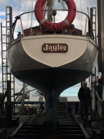

Postby Tales » Thu Jun 16, 2011 12:59 pm
A few years ago I was tempted to replace my mighty 4.5 hp outboard with an inboard.
I talked to a chap at Wichards who had fitted inboards to several Top Hats and he told me that get the best performance from the prop, one had to fair down thickness of the keel in the prop area to enable the water to get to the prop. Pretty sure I have seen a picture of a TH hull recently on this site with the fairing done.
http://www.wm-marine-diesel.com/wmmarine.htm
One of my mates down here did it when he built up his TH from moldings and with a 7 hp inboard he can out perform a normal TH with 10 hp. I’m sure it would pay dividends when reversing too.
