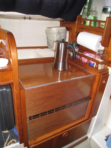

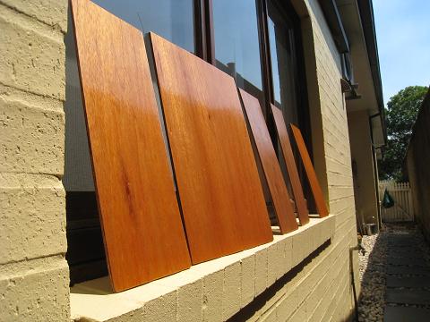

the fun of the top hat ownership is that I can work on it . :D (try to do as much as I can)

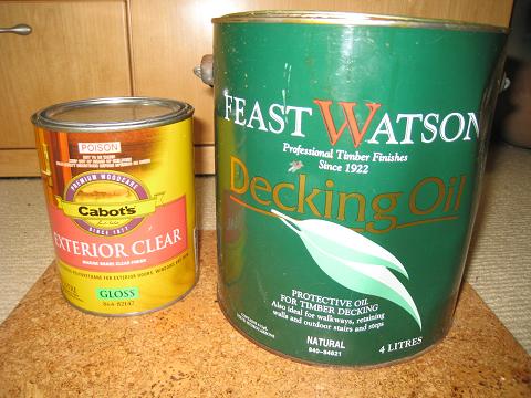

I did some varnishing using 1 coat -decking oil + 3 coats -exterior clear (4 hrs touch dry each coat) from Bunnings , see the result :P
the next job is to the outside timber work :? in cooler days

Looks great!!! Wanna come to QLD - only too happy to encourage this hobby of yours - ha ha... :lol:
