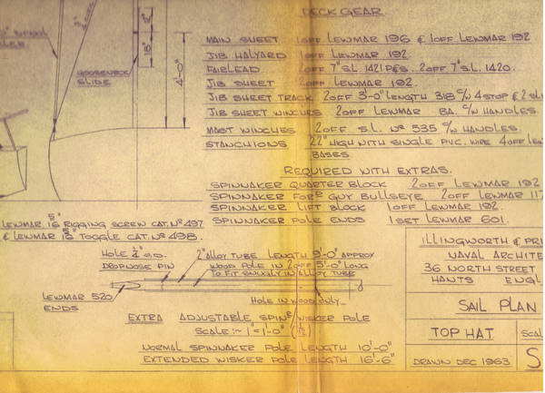

'J' from the Top Hat drawing is 10' so with Jim's 300mm it would come to about 11'.
I tried poling out our new #1 on Sunday with the spinnaker pole (8') and my arm and got about 10' 6" so 11' looks pretty good.
The Top Hat drawing also gives details of an adjustable spinaker pole using 9' of 2" aluminium tube with snug fitting wooden internal pieces however I can't quite read the fine print.
John (Bear) can you enlighten us please?

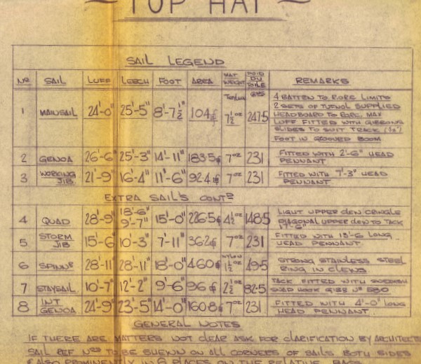

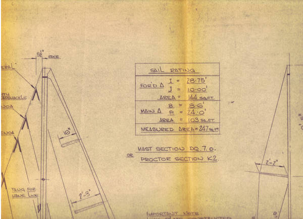

Postby bearmcnally » Thu Mar 10, 2011 4:33 pm
hello Top Hatters
Regarding spinnaker poles etc
Please find drawings attached . If I go down to Egret II this weekend I will measure my poles but my spinnaker is 460sq ft with wire luffs .

Re: Wisker Pole
Postby Sombrero » Thu Mar 17, 2011 10:07 pm
Bear (this has nothing to do with whisker poles), I am impressed with your pictures of the original plans information. However, I think the Top Hat sail plan has been modified at some time since their publication. Which could explain why our boats can be a handfull sometimes.
I have before me a sail plan which provides the following stats.
Mast length: 9400 mm.
Mainsail: Luff- 8229mm / 27ft.+/- 3 inches.
Foot- 2895mm./ 9ft. 6inches
Leech-8534mm./ 28ft.
Source: http://homepage.mac.com/clatimer/.Publi ... ilPlan.jpg
date 2/03/2009.
Conclusion: I think we are carrying more sail than Illingworth and Primrose had in mind!
SOMBRERO John.S
