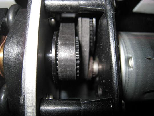

Postby 8philip8 » Tue Mar 29, 2011 9:14 pm
hi dan
this photo shows the retaining rings to hold the narrow belt on the gears ;)
hope it works :)
the gear cost about $10. if it works ,it'll save me $700 :D
