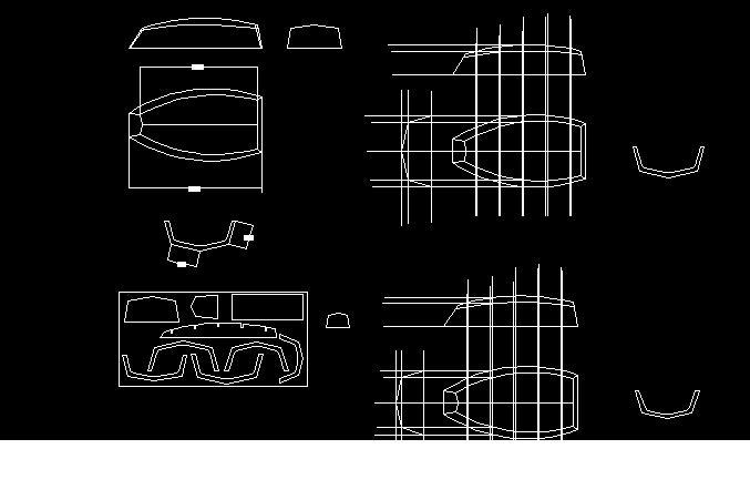

Postby rob.lovelace » Tue Mar 22, 2011 11:37 am
Im playing with the idea myself, I'll cut the frames out of 19mm ply and use 6mm ply for the skin here's a picture of what I have so far, it will use 1 sheet 19mm and 2 sheets 6mm ply. I'll use 42x19 mer for rails and gunwales etc (I've yet to draw them in) on the sheet is also a jig for assembly and the seat. O/A length is 1700mm and 920mm at its widest. If it works I'll post detailed drgs and B.O.M , if it doesn't you'll find it behind the shed with all the other failed projects.

Postby Tales » Tue Mar 22, 2011 12:48 pm
One of the problems I have found in a small dinghy is the fore and aft balance when loaded with either 1 or 2 people.
Saw and interesting solution recently.
The rowing seat was oriented lengthways to allow a shift in weight and 2 sets of rollock holes were provided.
If modifying an existing design allowance would have to be made for the removal the athwart bracing provided by the usual seat.
