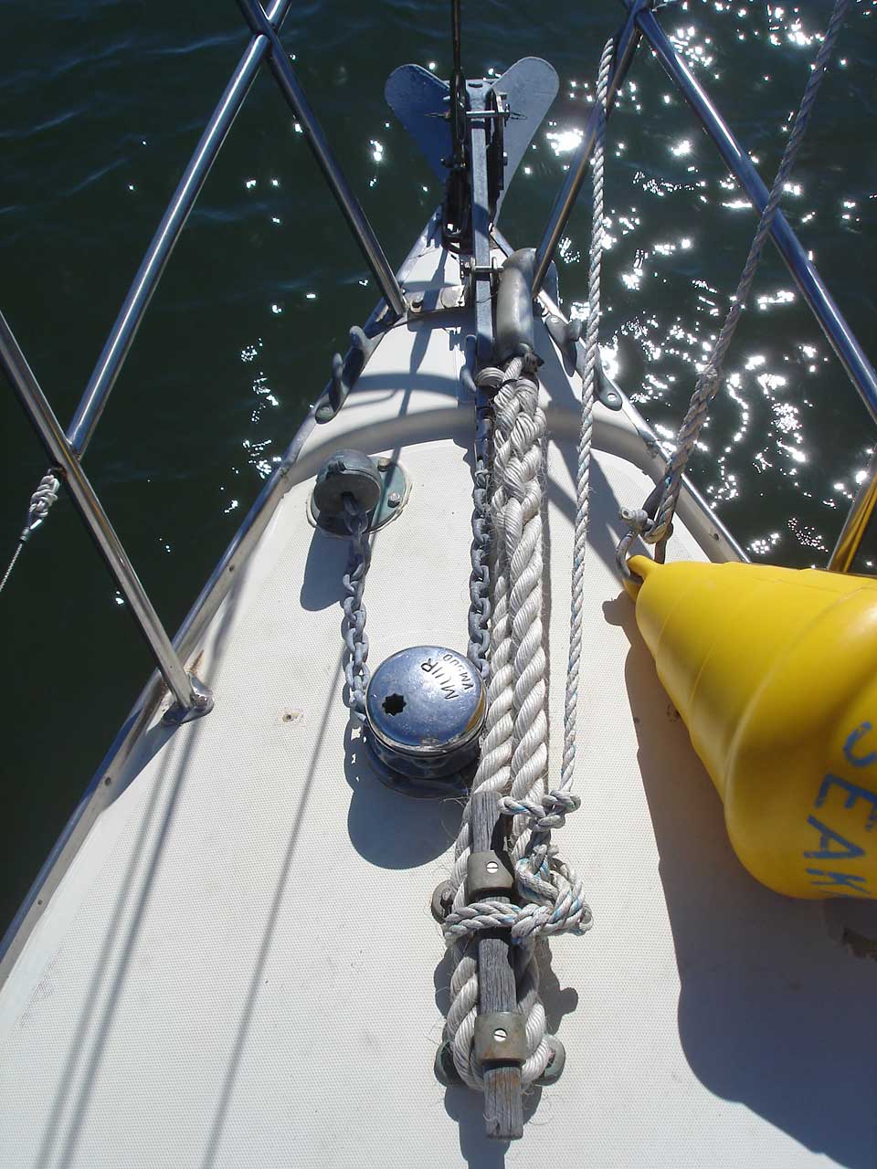

This is my arrangement on SEAKA :D , but some may question the choice of anchor, but that's what SEAKA came with and I have not yet seen any reason to change :D .
The anchor windlass is an old version of the present Muir VR850. [Page 166 in whitworths]
SEAKA's Bow.

You should never moor to the mooring buoy itself.
The mooring buoy should be attached by a light rope to a larger 1" or such rope.
This is the rope [the 1" one] you should bring back to your bollard. See my photo above.
You can the tie off the buoy to your pulpit so it won’t annoy you :D .
When anchoring your chain should also come back to your bollard via a rope anchor snub with a chain grab hook, see Whitworths pp98. You should never anchor using just your windless, its only for raising the anchor! :D
