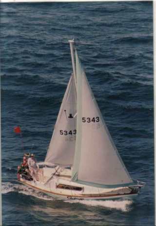

Gentlemen,
You can use a sail furled on a furler if there is padding in the Luff. Macdiarmid set up my No2 and you can reef it down to a No3. See the attached pic. There are 5 pieces in there. After that the body of the sail is too full and the shape is all wrong. There is too much tension on the leach and the foot. It'd be ok running though.
In 20 kts I often only use the N02 (cause I don't have a no. 1) without the main. That's because the sail plan is unbalanced with a lee helm until you get to stronger winds when the boat heels and the centre of effort in the genoa moves well outboard of the boat and counteracts the lee helm. In short what I'm saying is that in 20 kts with a No 2 Genoa working to windward the boat can be steered to windward with one finger on the wheel.
I once asked a sail maker to put a 3rd reef in the main and he wouldn' do it as the sail cloth is only light compared to a storm main. Sounds reasonable to me.
Further I was racing on a Cole 30 and the genoa started to pull out of the track so we took one wrap on the furler to stop it going any further until we got back to shore.
