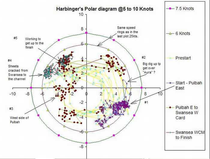

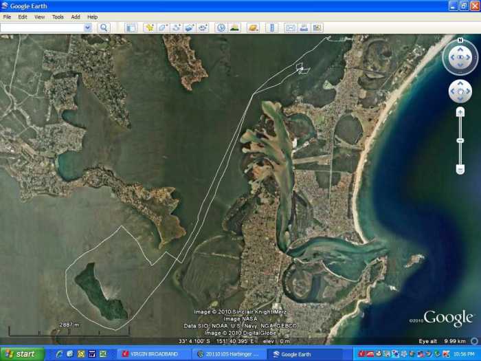

I thought you might be interested in this. I've been playing with the GPS plots for a Garmin GPS 60. I put the data in an Excel spread sheet and got these plots out. This is for an Endeavour 26, this is the track;
20110105 Harbinger Wed Pulbah Is a.jpg (42.88 KiB) Viewed 10032 times
The polar diagram is shown below. The bearings are COS, course over the ground not apparent wind.

Re: tacking angle
Postby Phillip » Sun Jan 09, 2011 3:53 pm
Ahhhhhh Greg,
Please explain! :geek:
So how do you get that info into Excel and how do you read the plot????

Re: tacking angle
Postby karl010203 » Sun Jan 09, 2011 4:33 pm
If I am reading that polar correctly you managed to pinch 30 degrees at times, am I reading that right?

Re: tacking angle
Postby Dolphin » Sun Jan 09, 2011 8:51 pm
G’Day All,
Karl, you are right the plot does look like the boat is sailing at up to 30 degrees but that section was taken at Pulbah Island where the wind was knocking and lifting and dropping out as you can see by the speed. Pulbah Is and Wangi Pt were affecting the wind greatly. I can adjust each point for the true wind but at that point we weren’t interested in it.
If we look at #4 and #5 that is in the unaffected wind. Well, as you know it still gusts and swings. You can see at #4 we were sailing at 60 to 75 degrees on a Starboard tack at about 6 knots. As we passed the channel we hardened up to 30 to 45 degrees and our speed of course dropped off to about 4 to 5 knots heading for the finish line. That is also course over the ground and speed over the ground COG and SOG respectively and takes into account leeway and apparent wind.
This data was taken over about 2 hours and contained about 750 points. The GPS was used in its normal mode. It doesn’t even have to be on deck, it could be in your bag as long as it gets a signal.
