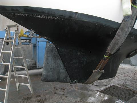

hi all
I've seen a few photos of props on top hat website
mine looks difference to them,
I've a 10hp sole diesel.
I like to know has anyone got one like this?
"SYLPH"

I am guessing this has been retro-fitted as the rudder has not been cut out... others on the site will be more knowledgeable on this one than me...
Out of curiousity how does it motor and turn? Prop walk?

hi Karl
I don't have much experiences on other top hats.
so can not tell the difference!
she turns sharply, when rev. she pulls to port.
that's all I can tell at the monent.

The set up shown (offcentre shaft with a cutless bearing ) was available as an option when purchasing a Tophat new. It has two advantages over the trational set up: you can remove the shaft without taking the rudder off; and the set up provides more thrust as the prop is clear of the rudder. Storm Petrel (Mk11) has the same set up, with a two blade prop. It does have a little prop walk (especially in reverse) but it is not a problem now I am used to it. Looks like your prop also has a coat of 'Propspeed'. I have tried Propspeed over the past three years and found it be great for the first 6 months after application but I have found that it needs a monthly clean after that.
What speed does your Sole push the boat along at? Tophats are a heavy boat for their size, and you propably would only expect to achieve 5 knots (6 max) on smooth water with a clean hull. Perhaps it is just a matter of getting used to the set up. "If it aint broke.......?"
