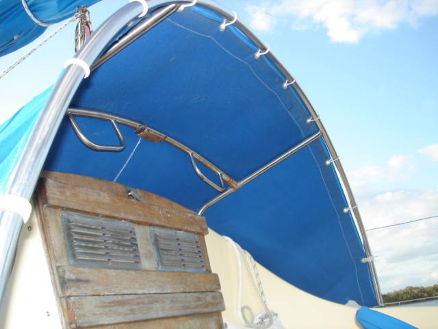

Postby longdeepthinker » Fri Nov 20, 2009 9:33 am
Hi Tom and Phil,
That is my Dodger in the pics and was on the boat when I purchased it.The frame appears to be quite solid and the dodger adds to the appearance and comfort factors.
My boat also has a Bimini and I will try to talk Phil into posting some pics of same.

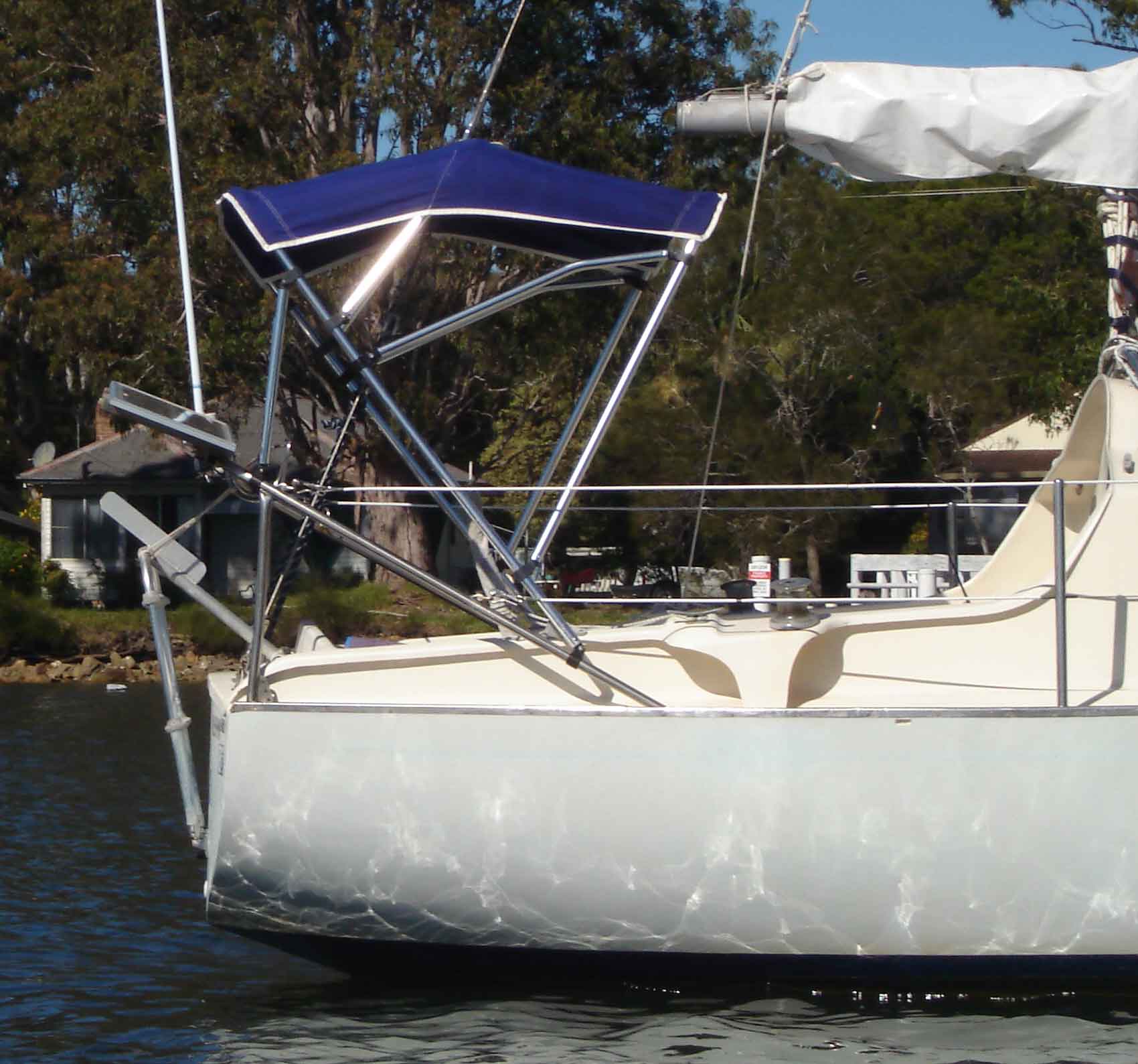

Postby Phillip » Fri Nov 20, 2009 7:55 pm
Hi Tom & John,
This is my Bimini, its an Oceansouth WhiteWater 1.5 to 1.7m width, height 1150mm size B, Bias Boating code 6381.
As you can see I have reconfigure it so that it attaches to my stern pulpit You need extra fittings and a lenght of tube.
If you want to do it this way I will make up a shopping list for you. About $300 + transport. It is also advisable to get the storage boot if your boat sits around, to protect the bimini from storms and UV. I also had the canvas cut and velcro put on to allow the back stay to pass through (I will get a photo).

Have a look at the photo again and you will see that the Bimini is clamped onto
the stern pulpit in two places on each side. No need for any extra holes! :D
