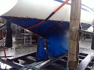

Postby Allen » Sat Oct 17, 2009 9:46 am
HI Phillip,
thanks for the info.
the whole rudder would lift by a couple of inches - and the bottom of the rudder would lift off the lower pintle.
The shipwright has built up the top of the rudder to reduce clearance between rudder and hull.
Attached is a pic but it's not very helpful.
The delivery from Rushcutters Bay to my mooring at Sylvania Waters is to take place tomorrow - hopefully westerlies will have eased a bit.

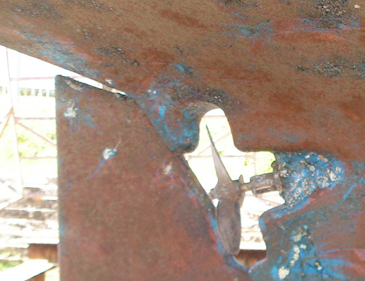

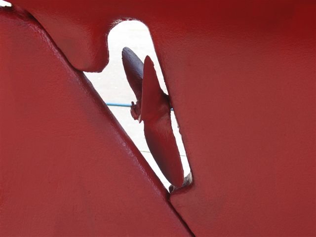

Postby Phillip » Tue Oct 20, 2009 9:51 am
Morning Allen,
Found a photo of SEAKA's rudder, does yours look like this now?

Re: new boat - new questions
Postby mmts » Tue Oct 20, 2009 12:36 pm
Hmmm,
Interesting arrangements, mine is different again
Postby Tales » Fri Oct 23, 2009 11:58 am
Interesting to note the fairing off upstream of the propellor on some installations.
Two Top Hat people in the past have told me that it is important to fair off in this area to get good performance.
Postby Phillip » Fri Oct 23, 2009 2:16 pm
Afternoon Tom,
I get the hull speed out of my Mk1 (just over 6 knots) and she turns within her length.
I can't see how fairing off would make any difference apart from blanking the prop off a bit.
Any comments?
