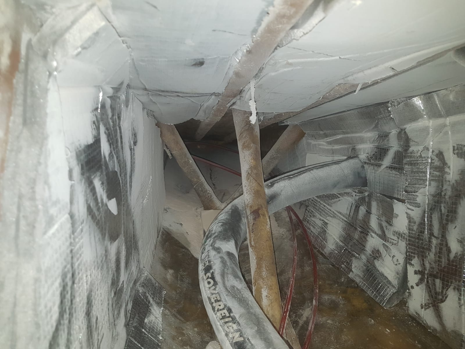

When my Mk1 gets to 5 knots the drains begin to suck up a bit of water.. not a great amount but feet get a bit wet..
I'm planning on getting the boat out to antifoul etc soon and was thinking about options for the drains..
Currently the 2 x fibreglass tubes coalesce and exit together in the midline down low as seen here
aft of engine.jpeg (183.14 KiB) Viewed 10445 times
What if blocked up these drains and put in two new ones further aft and higher up the hull.. Is there anything stopping me putting some drains just out through the transom / above the waterline?
Excuse the cobwebs/grime it's going to get cleaned up and repainted shortly..
Any help appreciated

I know what you're saying about the cockpit floor being low but i can't see an issue with drilling some holes in the transom and taking the drains or the back. How would that be an issue?
I don't think the stern digs in enough to put the back of the cockpit floor below water level. You can see in the above photo how high out of the water it is.
The current drains suck water up them as speed increases.. a drain out the transom.. that's my idea.. why not? Anybody?

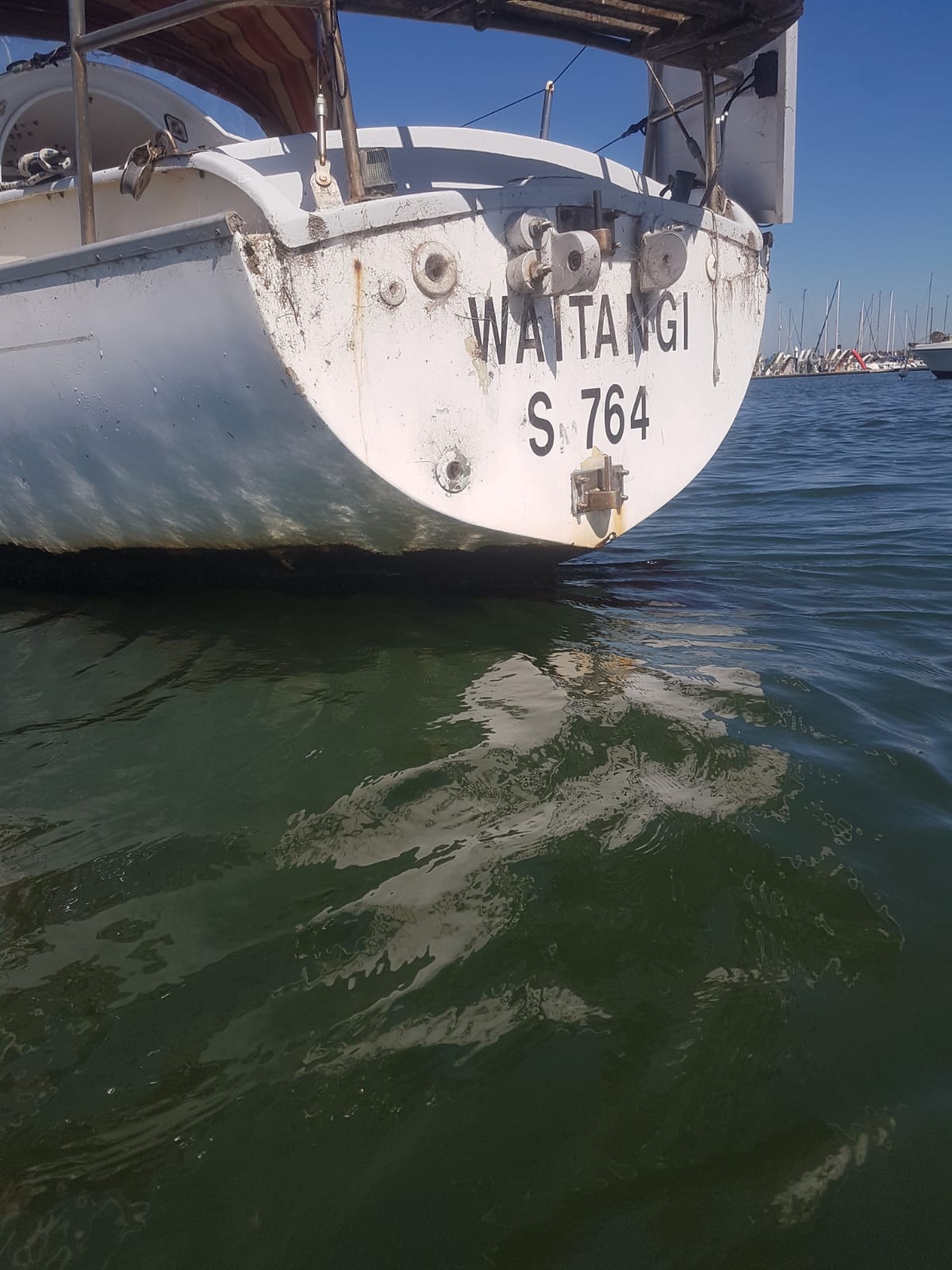

My Mk2 cockpit has rear drains, which are fine at anchor, but accumulate about 1litre in cockpit when heeled over. This tends to lie in the forward of c'pit, giving wet feet and wet cushions when they slip down. :cry:
I will find some 2" rubber bungs; to be removed when moored or when likely to take in a big sea (never happened yet!).

by saintpeter
Sorry, SailTime. I can't get down to Kittiwake for a few weeks yet. Rear cockpit drains (each side) fall aft through the transom. When sailing heeled (nearly always in Pt Phillip Bay/Bass St.) water - less than one litre - lurks in the leeward cockpit; just enough to wet feet & cushions! A pair of temporary bungs will be tried this season.
