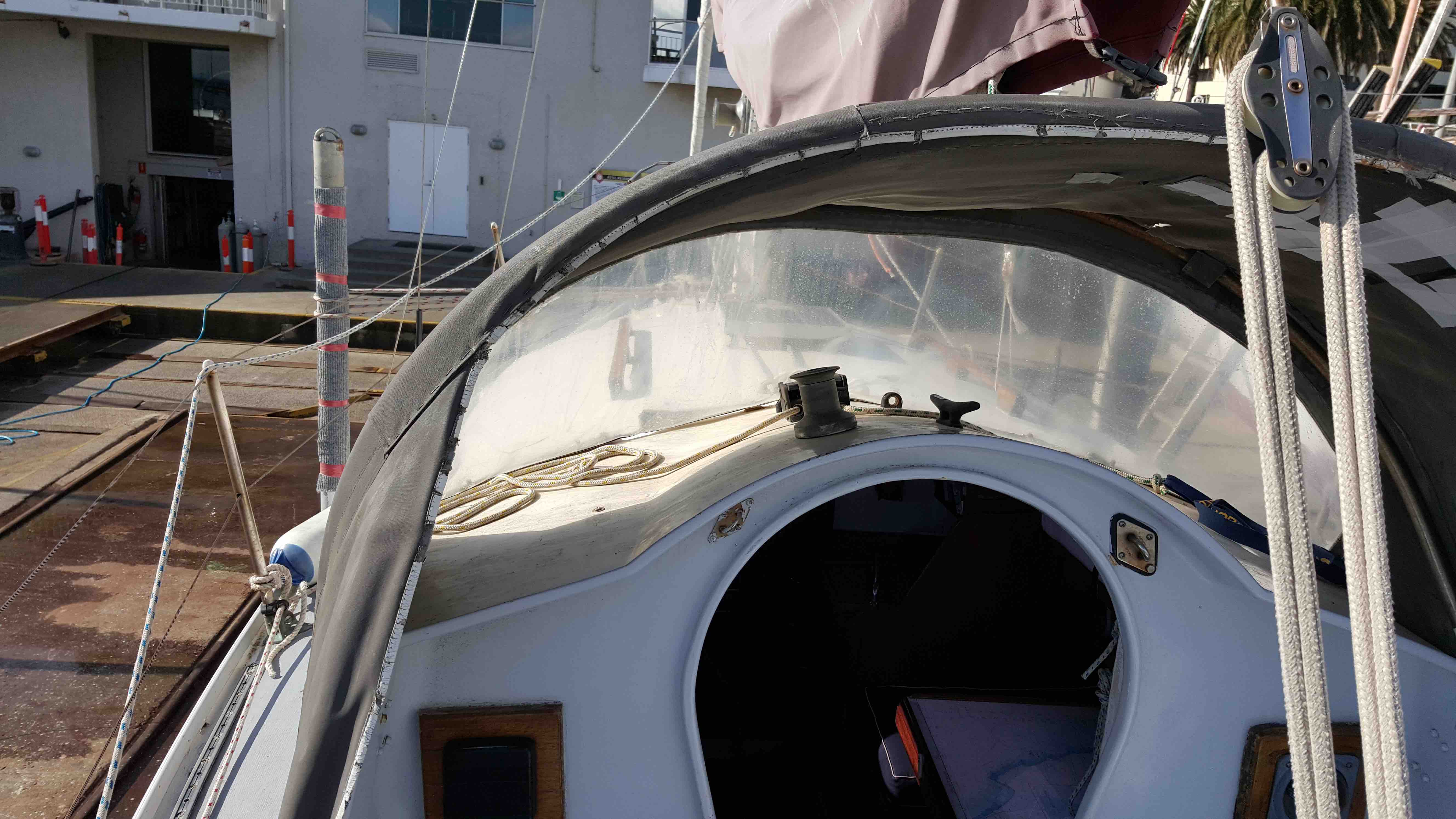

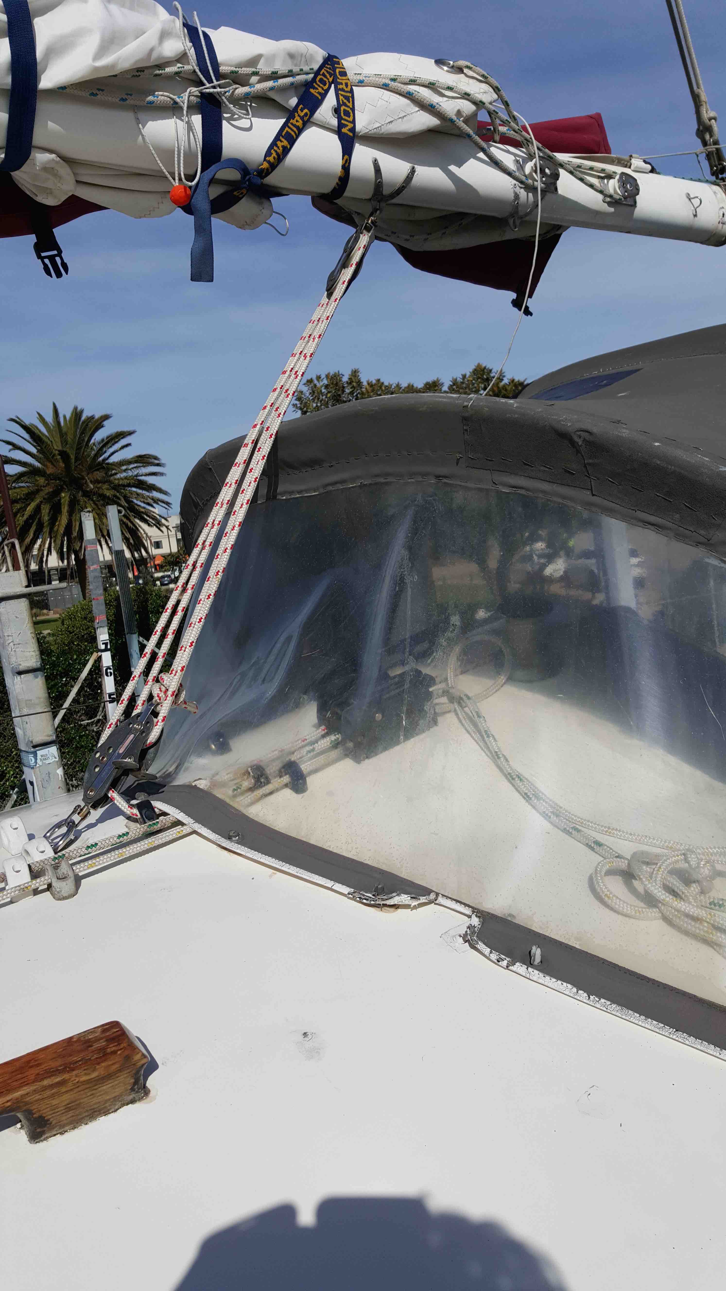

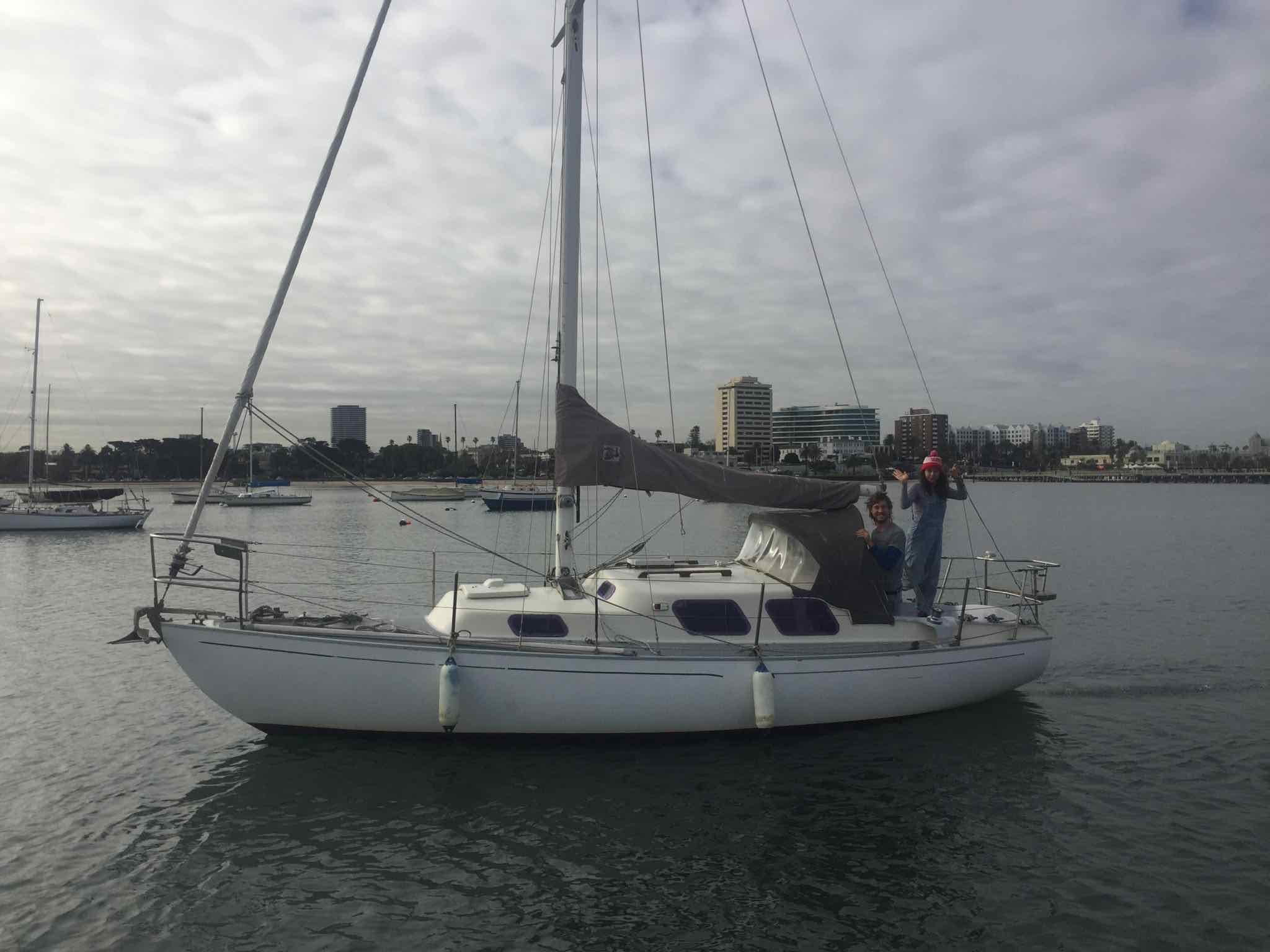

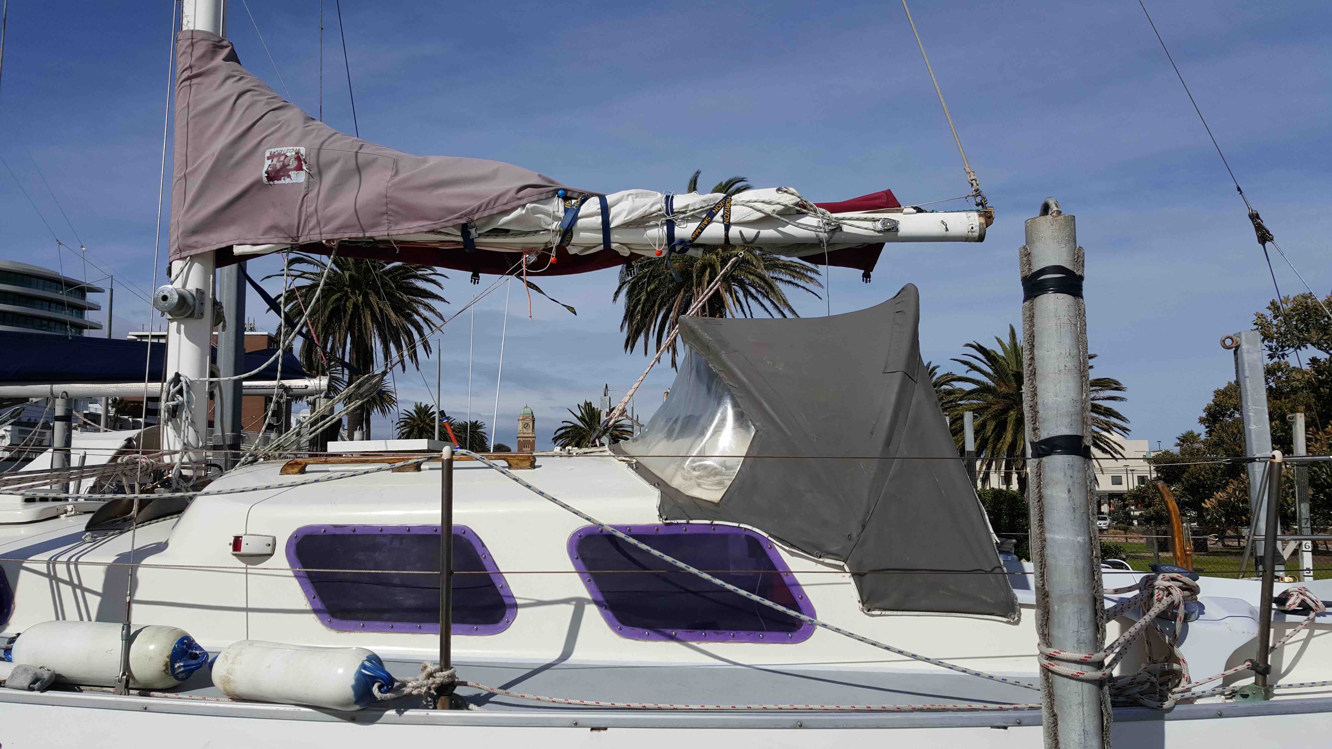

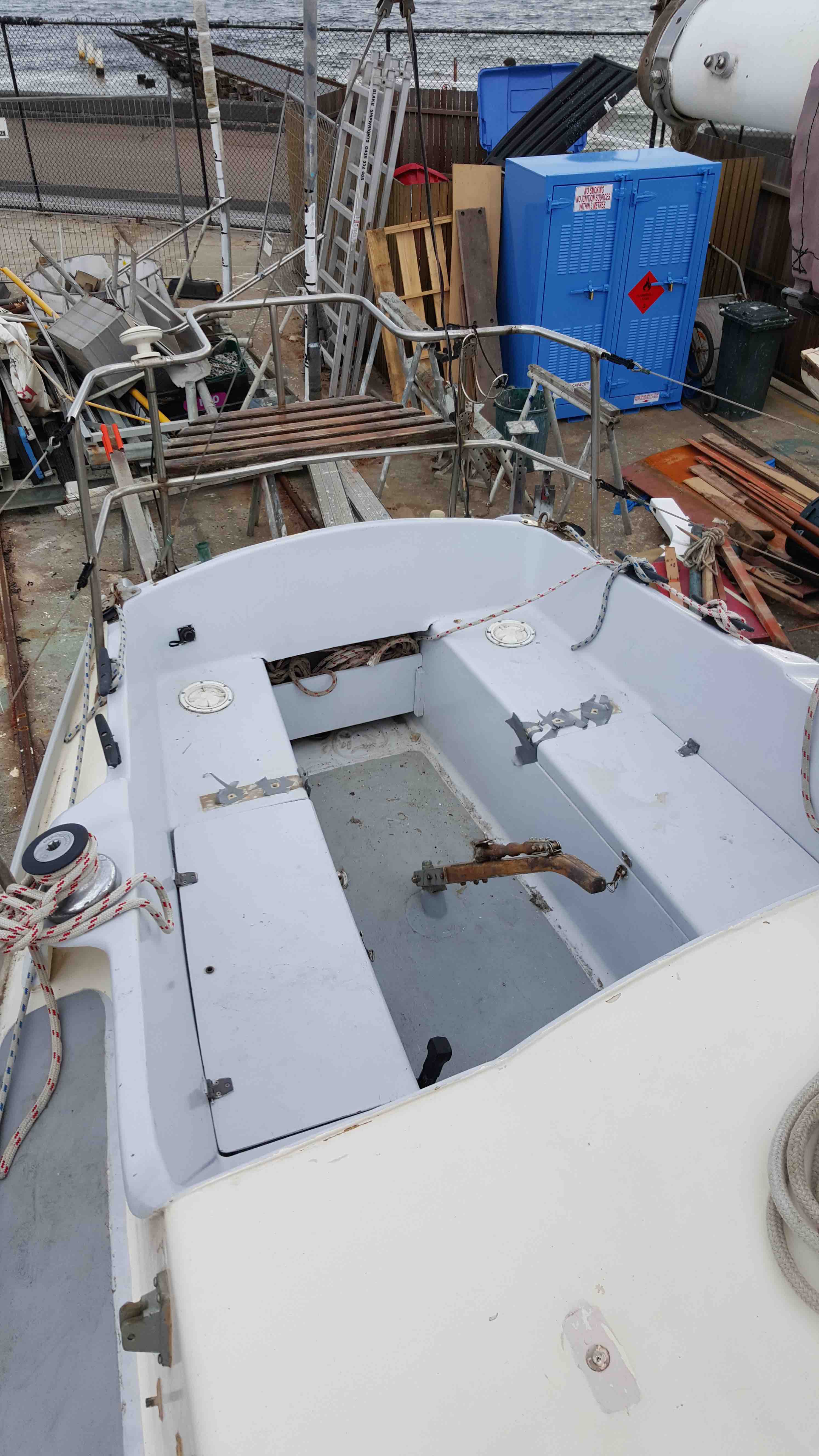

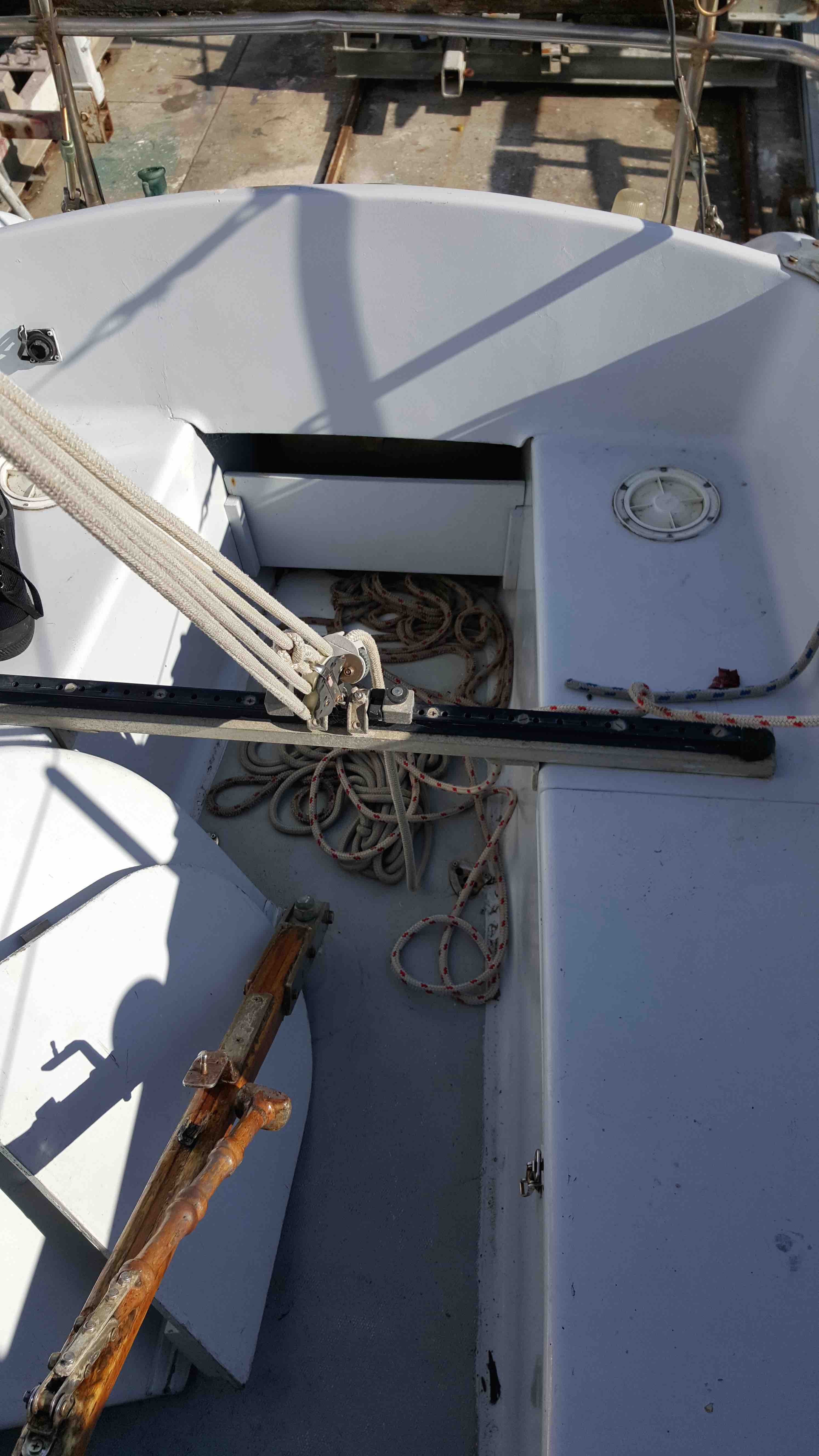

My dodger is great but makes the main sheet position tricky. My cockpit was split by the traveler and the mainsheet so I'm experimenting with moving the main sheet to mid boom and losing the traveler.. in my experience the traveler rarely gets moved from the middle anyway (which everyone disagrees with! but i still see them always in the middle.. ) and i think having a good vang to keep the boom down is good enough for sail shape.. what do people think? I've been reading up on it a bit and no traveler seems to be reasonable..
It's freed up the cockpit but i haven't sailed it yet
anyway here's some photos of the dodger and new mainsheet setup etc
shea
heres the dodger setup, you can see the mainsheet hanging off the end of the boom attaching in the cockpit - i've been jealous of THs with a clear cockpit
heading out.jpg (128.63 KiB) Viewed 8955 times
dodger needs replacing.. rips at a glance
dodger 1.jpg (590.14 KiB) Viewed 8955 times
traveler gone.. so much space! epoxy filling in holes
cockpit space.jpg (580.98 KiB) Viewed 8955 times
the problem is the sheet is contacting the front of the dodger so i have to move the boom attachment slightly forward
mid boom port.jpg (604.11 KiB) Viewed 8955 times
there was a sheet attachment already on the boom so I went to that but will move it forward a bit so not hitting the dodger
mid boom 1.jpg (509.83 KiB) Viewed 8955 times

I think id prefer the main sheet traveller left alone somehow with the dodger working around it. a bit tricky though aye!
Personally i like the option of having the main traveller hard to 1 side.
Interested to see more dodger applicatons!

You could install a round bar traveller. This is essentially the same tube as your bow rail, fitted in an arch across the front of the dodger to the top of the coach roof. The lines controlling the car (different to a norma car) it can be led through small blocks and back to remote jaw cleats closer to the helm if need be.
Or, there are some companies who sell traveller kits for boats with dodgers. It's worth a google.....
A traveller is important for some points of sail to keep the sail shape whilst sailing off the wind, and can be used to come even closer to the wind in some circumstances.
