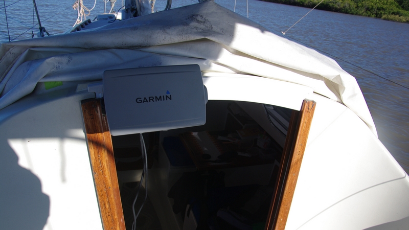

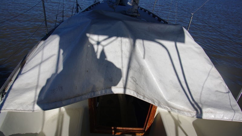

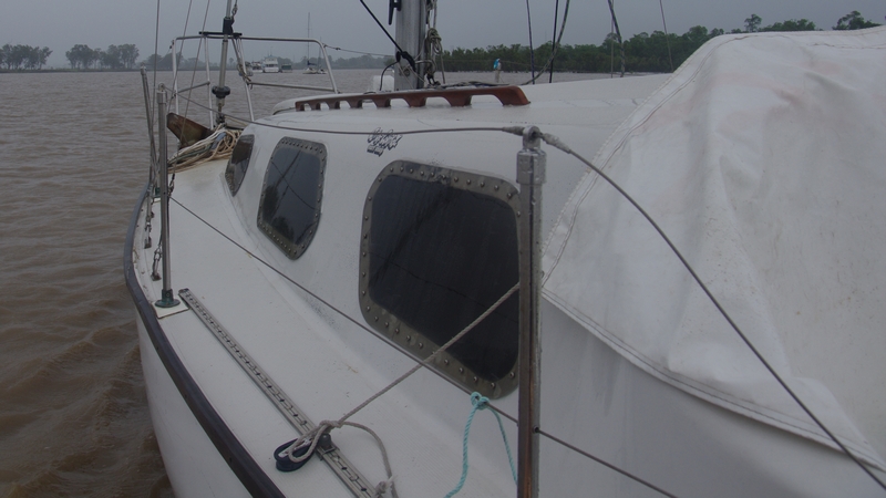

Hey Dave, this is NOT what you are after but I thought I would add it for those who are reading the thread and interested in various options for a bit more protection over the companionway.
Originally I wanted protection for the companionway for the tropical storm season when Windchaser spends most of her time sitting on a mooring or anchored down river to avoid the worst of the flooding. Got a small tarp that was once a sign, tough material, rope running top and bottom. It was not custom fit, just an experiment. Tied on both sides and in the middle top I cut a small hole so it could fit over part of the traveller and so not slide off. I found that with the rear two ropes untied, I could easily get up and down the companionway and the tarp was not in the way.
The tarp kept water off the top of the companionway where water used to leak in past the washboards. Then I realised that the tarp was not just handy when Windchaser was vacant. I could motor in light showers with the tarp in place, with the rear ties not done up and it kept rain from going inside the cabin. If the rain was heavier or coming from behind I could put in the lower two washboards, which go up half way, and the tarp protected the rest. It meant getting back inside the cabin from the cockpit only needed taking out one washboard as the lower one is very small, most of the rain was kept outside.
Rolled up, sits out of the way for motoring. Just watch the ropes when stepping out of cockpit to go up the front.
When on board anchored, the lower edge of the tarp can be lifted up a little which makes a bit of a roof over the companionway, allowing me to look out from inside the cabin but not allow water to come in. It does require a little bit of bending to get past it into the cockpit but in rainy weather and anchored I enjoy the protection and extra air that can come through.
More than just wet weather, I have found it a problem when anchored, when the sun was setting (or rising) and strong sunlight was coming straight in through the companionway. With the tarp, I just pull it down a little and it provides a sunshade.
At night when sleeping aboard, I can put the lower two washboards in, pull the tarp down (from inside the cabin) and it provides a privacy screen plus still allows air to flow through the cabin as the tarp is not sitting hard against the companionway but poking out from it allowing a good gap.
Works as a late-afternoon sunshade and privacy screen.
My tarp needs a good clean to the get the mould off, but what started as an experiment to help keep rain from seeping in past the washboards through the rainy season has proven itself in many conditions. I have been thinking of ways to customise it since it has done so well. Time and again, in rain and in sun, I have found that flexible and cheap bit of protection very useful. Not for everyone, but this type of arrangement may suit some.
