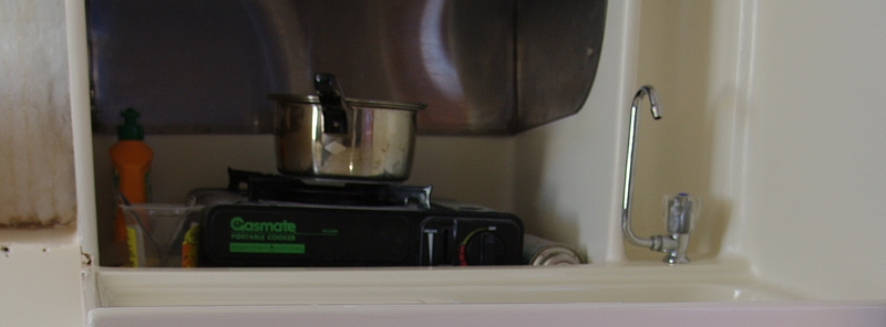

I've included a dodgy pic of my stove hutch. It has the top three quarters lined with ss sheet welded to shape. I do not think I would use a cooker in the hutch without the metal lining as it gets very hot. That's my opinion.

Troppo,
I've also got a SS lined stove area, seems to be the norm.

Brandon,
Metho stoves are good but they can produce quite high flames when first lit. A metal surface above the stove is highly desirable. I am not sure that metal sides are necessary. You might consider whether the sides are far enough from the burners to be safe. I have a metal tray below the stove to collect any spilled and burning metho.
Stainless is probably ideal but aluminium is much easier to work with. Thin aluminium sheet is available from Bunnings. You could investigate fire retardant paint which might save you a lot of trouble.
It is definitely worth getting to know how to use the stove in the backyard before taking it on board. It is also useful to have nearby a plastic water bottle with nozzle so that you can squirt water onto any metho which is burning out of control.

Hey Troppo,
I guess living up in those cyclone and flood prone areas, you are used to risk, but some of us chicken Southerners believe that the LPG portable gas stoves can be an explosion and fire risk. There is heaps of discussion on the matter on a number of forums, so you pays your money.......

Ianb wrote: LPG portable gas stoves can be an explosion and fire risk.
I think there are significant differences between the butane stove I use and general LPG portable gas stoves. The butane gas canister is tiny compared to a LPG cylinder so in the event of a disaster it will only blow up half your boat not your whole boat. So you have a 50% chance of surviving an explosion from my type of stove but 0% chance with a standard LPG cylinder unless you were on the beach at the time of the big bang [I just made this up. It is a fact there is way less gas but I don't know exactly how much difference there is in danger between big and little gas cylinders].
The key difference is that the butane cylinders have a safety valve and no piping. When you go to turn on the stove, you push a lever which allows the gas to flow straight from the tin to the burner. There are no connections that can be loose or cross threaded and leak, there are no pipes that can crack. Once that lever is flicked off, the gas is shut off, the can is safely removable.
In my opinion, the butane stove has the danger same as all gas stoves that the flame could go out when I am cooking and gas can build up inside my boat. However, I don't leave my stove unattended when cooking as burnt food does not appeal to me. Some would say my cooking does not appeal even when not burnt but that is another story. The butane stove can not leak gas when just siting there as the gas is turned off at the can and there are no pipes or connections that can leak. I would prefer a metho cooker as I personally like them, but my risk assessment of the butane stove is that it has way less risk than a typical LPG cooker. I think there is more danger from eating my cooking than from my butane stove blowing up.

Thanks to all that have responded. The info about the lining was most useful and the resultant stories about metho v butane and subsequent arguments are definitely part of the charm of this site.
