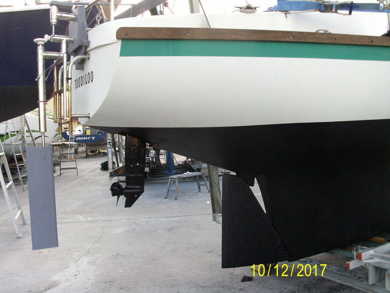

Tohatsu ultra-longshaft
rsz_pic_0017 (2).jpg (114.48 KiB) Viewed 8948 times
I agree with Ianb that a motor mounted in the well is to be preferred. You need to get the prop as low as possible and as far forward as possible to avoid cavitation in a choppy sea.
Having the motor in the well allows you to mount it lower than if on the transom as it is protected from waves.
As Ianb says, it also makes repairs at sea much easier. I once caught a line around the prop and was able to lift the motor out and remove the line quite easily.
The downside of having the motor in the well is that you have to lift it out at the end of each day. To make this easier, a lightweight motor is preferable. 2 stroke engines are significantly lighter than 4 strokes.
I recently replaced my Mariner 8HP longshaft, which had served me well for 25 years, with a Tohatsu 2 stroke 9.8HP ultra-longshaft. This gets the prop deep into the water as shown in the photo below. The Tohatsu weighs only 26 kg so is significantly easier to lift than the old Mariner which was several kg heavier.
In contrast the FT9.9 is 49 kg. This weight mounted off the transom will adversely affect the trim when sailing.
