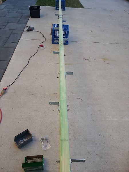

Postby swavek » Mon Oct 14, 2013 9:09 am
Hi Everyone,
Thanks for all your advice in regards to climbing the mast in order to put a main halyard through the masthead (i.e. no mail halyard at all at present).
It took a while for me to have a day free from work (I work 7 days) and also to time it with a day of little wind to do the job.
But finally I got it done and the ladder is up and attached to the mast.
I've climbed it all the way and it works great. Very sturdy.
Next step is to get all the gear together and head up there to put the main halyard through the sheaves and down through the mast.
I also want to install a wind vane and check what's happening up there generally.
The furler roller bearing swivel thing up top looks like its had a few modifications over the years from previous owners so I want to check it all out.
I have also bought a new Rolly Tasker headsail from a fellow Top Hat owner and want to change it over as well.
Once the halyard is in place, I will attach it to my harness as I climb up there with a friend assisting down at the winch.
I've attached a few photos. Will keep updating as work progresses.
Amazing how much pleasure you get from working on your boat.... except the amount of money needed in my pockets every time I head over to Whitworths! :lol:
Installing the angle bracket steps every 500mm
Mast Ladder1.jpg (111.26 KiB) Viewed 14276 times
Bracket to join the two 4 - metre lengths together
Mast Ladder2.jpg (120.38 KiB) Viewed 14276 times
Ladder sits on top of a piece of timber for extra support
Mast Ladder3.jpg (143.08 KiB) Viewed 14276 times
Cable ties all the way up
Mast Ladder4.jpg (93.05 KiB) Viewed 14276 times
Having a breather near the top
Mast Ladder5.jpg (76.53 KiB) Viewed 14276 times
Ladder is attached and safe on the mast
Mast Ladder6.jpg (92.35 KiB) Viewed 14276 times
