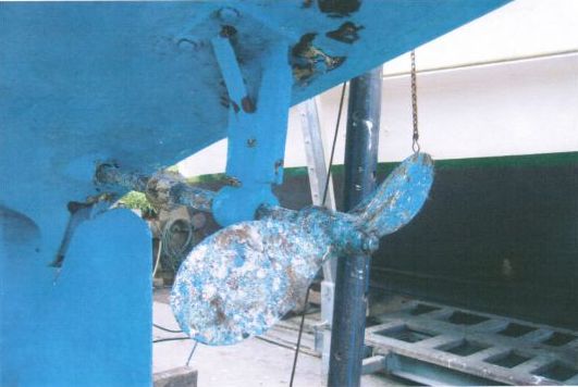

You may have to fit the diesel like this on Alley Oop.

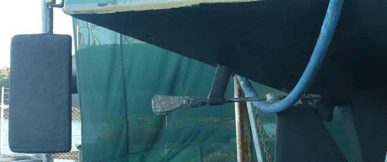

Storm Petrel has an offset prop shaft which was fitted to the boat originally and has worked fine ever since (as far as I can tell). Perhaps this is another option you could consider. It enables the prop and/or shaft to be removed without taking the rudder off and I suspect it drives the boat a little faster than having the prop sandwiched between the keel and the rudder..

Postby Dolphin » Sat Jul 09, 2011 11:10 pm
G'Day Rob and Mark,
Here is a photo I hope helps shows the setup on a Mk III.
I would also recommend, if you can afford it to fit a folding prop. The sailing performance is really good.
I just (2 years ago) had the Hatz (BMW) Diesel replaced with a Volvo 12 Hp. There were minumum mods to be done and that cost 10k for the engine and 4k for the fitting. Do you really need a 15Hp, maybe you could save a bit there, but at the same time its probably good to have a bit of power up your sleeve.
I put a rudder on the transom as the slow speed manoueverability was, I thought, bad. Mark??
Cut and paste the pcture to see the whole shaft.
Mk III propeller shaft

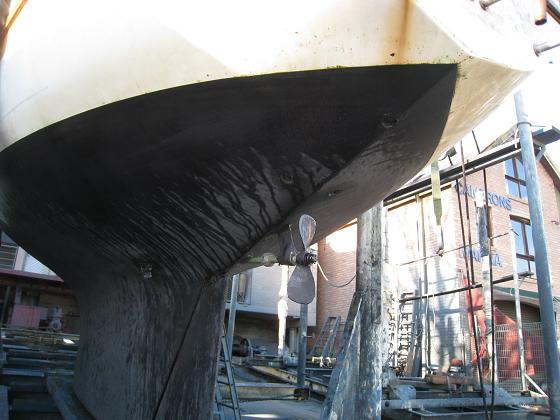

Postby storm petrel » Sun Jul 10, 2011 9:28 am
here is an old shot(5 yrs) of Storm Petrel's setup.
Storm Petrel's off centre prop. circa 2007
Storm Petrel Propeller (1).jpg (29.79 KiB) Viewed 9425 times
