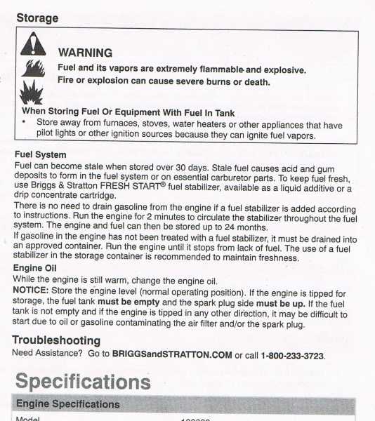

I was told it was 6 weeks but here in a Briggs and Stratton Manual for the 4 stroke motor mower it says 30 days. If you use a fuel stabiliser it can be used up to 24months.
Briggs n Stratton storage.jpg (52.13 KiB) Viewed 7323 times
Diesel doesn't deteriorate, although a small BMW I was working on the fuel turned to gum and blocked the fuel lines.
