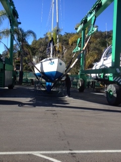

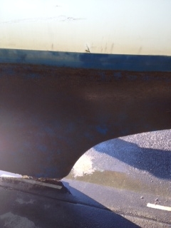

Sealady when first pulled out of water
Small 1.JPG (67.14 KiB) Viewed 10371 times
Note lovely black river scum.

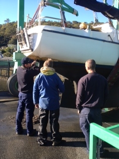

On the travel lift at Fenwicks.
Very clever machine.

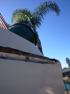

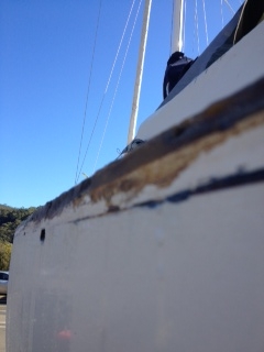

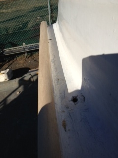

Side of boat.
The join between hull and deck with buggered toe rail removed.
This join was not very even.
Years of silicon poured in to hold and fill toe rail rot.
Shipwright has had to rebuild and make this join even with Epoxy.
Also Toe Rail was only bolted on in 3-4 places each side

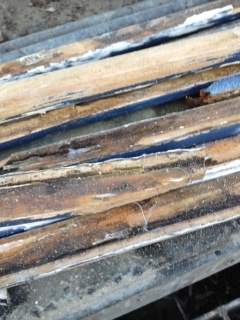

Postby SeaLady » Wed Jun 20, 2012 10:33 am

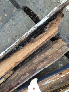

Old buggered toerail literally fell apart in places.
The worst bits had already been thrown out before I took photos.

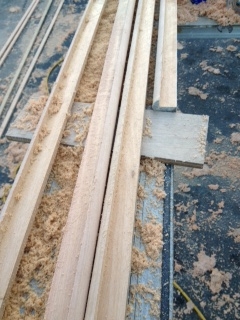

Postby SeaLady » Wed Jun 20, 2012 10:41 am

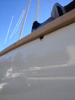

New toe rail made from white beech.
The timber is very very oily.
Difficult to sand as it almost feels like it has wax in it.
The wood shavings when squeesed act a bit like playdoh.
2 coats of Evidure is being painted on the timber prior to varnishing.
Apparently it soaks into the wood and makes a hard surface to allow for the varnish to last longer.
