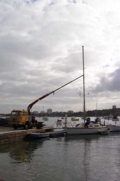

Felicite's rigging was replaced in Aug 2000. ( i've got an insurance survey coming up soon) It was done along side a wharf at the yacht club, A set of sheerlegs ie two 6m long wooden poles were rigged in front of the mast and lashed about 500mm from the top. They were stayed fore and aft to the mooring post and the winches at the rear. Some how a block and tackle was rigged to take the load. It was quite some time before it could be lifted as the base was Araldited into the mast base. There was a post from Mr Killick on what is in the mast base.
On the 30 footer that we lost the mast on the second time it was replaced by a crane. It was a race to beat the tide as the crane only just had enough reach to get the mast.
At the LMYC there is a dedicated mast crane consisting of a pole with a simple arm and a boat trailer winch.
