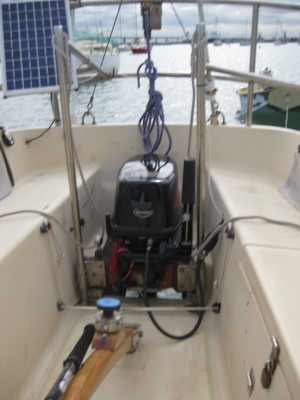

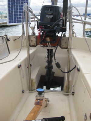

Hi Karl and anyone else who has a well and is interested in the lifting and lowering device set up in Sombrero. The pics show the outboard in the up and down position. The actual pipe work is pop riveted to the pushpit at the side and rear of the pushpit itself. You will note that the bottom plates on the vertical poles are bolted in the cockpit floor to put the outboard in a position where it would normally be if the normal mounting bracket was bolted directly to the back of the cockpit . Height of the framework is determined by having the motor, when hoisted, clear of the bottom of the hull. My photos should show how the whole thing works and goes together. If you are interested and have more questions, or need more close up photos, I would be only to happy to respond to your request. It may look complicated, but it isn't and the reward is worth the effort.
Regards, John.S "Sombrero"
outboard up
outboard down

Hi John
It magically found it's way back into the right section - yay!
A lot of thought has gone into that... and it certainly seems tidy and I would imagine easy to lift and drop... nice bit of engineering!
Thanks for sharing :D

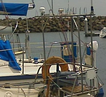

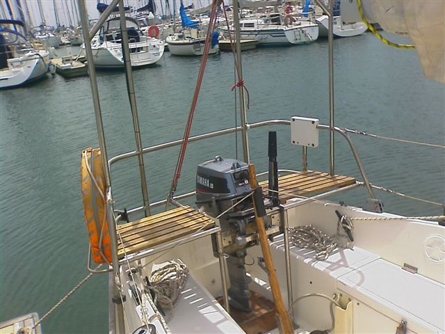

Here is another version of the retractable outboard motor in the well.
It is the MKII " Bonnie Lass" and looks a very practical arrangement with the lifting tackle and seat each side.
There is also other equipment including a solar panel on top of the structure but not in the picture.
Below the leg is a nice wooden cover which is held in place by the motor and stops those splashy waves coming up onto the lee cockpit seat in rougher weather.
Bonnie Lass retractable motor and well cover.
Re: Outboard Motors......
Postby Maggsy » Mon May 03, 2010 1:01 pm
Hi Tales,
Can you post a photo of the top of this arrangement. I have been thinking about mounting my solar panel on an extension of the pushpit (which will also incorporate a bit of shade). At the moment my solar panel is on a flimsy flat steel arrangement at the back of the boat.
I like the arrangement of the motor between the two seats. I have a bench seat across the back and have to man-handle my 6hp merc in and out of the cabin every time I head out. I definitely have bigger arms than before i bought Sea Monkey!
Regards ...Ian
