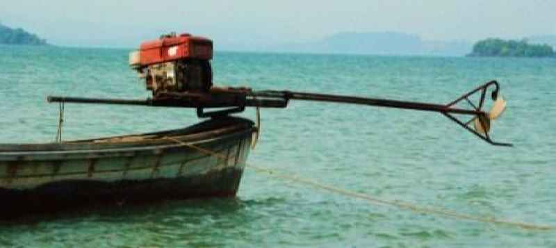

Seems to be that maybe the answer is different motors for different folks, but maybe we shouldn't limit the options to Inboards & outboards/petrol or diesel. Here's an option that would be especially useful for running over those shallow bars, and Troppo coould use it to dice up any Crocs that come too close!

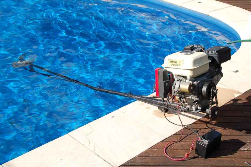

And as for what HP is needed or is most suitable, well obviously Long Tail motors are powerful enough... cos they can even power a swimming pool!

RodM, thank you, that propulsion system could be just what I need. I would get 2 of them. one mounted on the front would not only help handle the crocs but could dig through those pesky minor mudbanks I run into.

These two pictures take me back to 2002 when I was living and working in Koahsiung Southern Taiwan , when during semester breaks my then Brazilian Girlfriend and I would go on a holiday to other parts of Asia . This stern drive set up reminds of when we took a boat ride along Bang Koks ( Thailand ) water canal system by a similar looking vessel ( more a like a large Gondola ) ....
Sure would add some complexity to this thread !!! ( lol )
