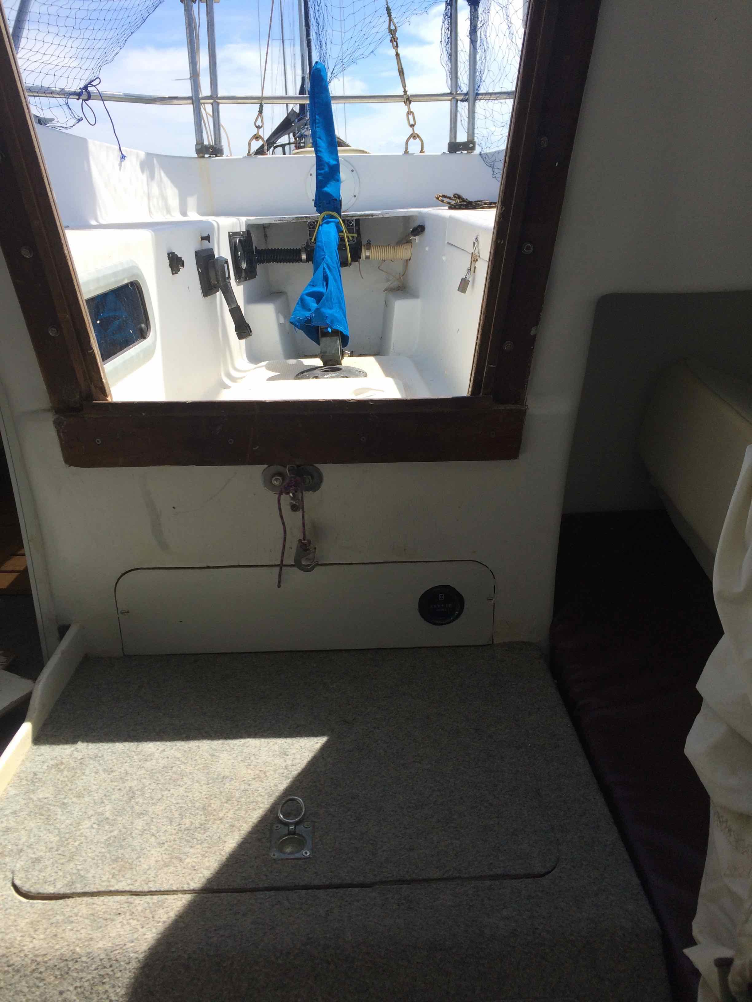

Finished off the install of an hour meter to track the running time of the engine (Yanmar 8hp) in my boat. Thought it would be helpful with keeping up engine servicing on schedule. Hardest part of the install was tracking down a wiring diagram for the engine remote control panel and then finding a suitable wire that provided 12VDC when the key was turned on and the engine was running. Appears you can't always rely on the colour coding as shown on a wiring diagram. Who would have thought?.........Anyway, found a wire, mounted and wired in the meter and voila!, it began clocking over when I started the engine.
Hour meter location
Hour meter_1.jpg (304.73 KiB) Viewed 13858 times

Neil,
I also have installed an hour meter combined with an RPM meter. [brought on eBay from USA for about $100]
I used a direct link to my house battery with a fuse and an on/off switch.
Why? I wanted to avoid the voltage spike when I started my engine.
I have my GPS on the same system as the starting voltage spikes always turned it off
and that's not nice when you are approaching a bar etc and need the engine and then loose the chart plotter. :shock:

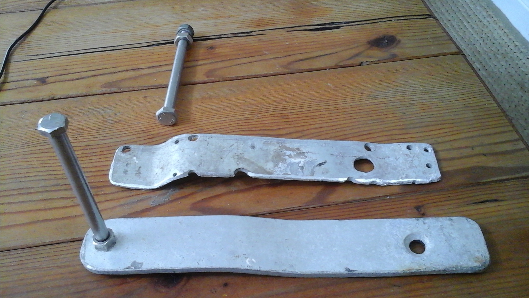

Main winch handle vanished over oard some time ago. Been using my spare. Decided to make a spare spare as I haven't found a replacement. Rough piece of aluminium was all I had.

Woodsy that's pretty sad. Lol but clever

I do good rough!
