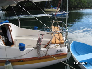

Postby 8philip8 » Tue Apr 06, 2010 9:45 pm
the best sit in the boat (princess sit)
8philip8
