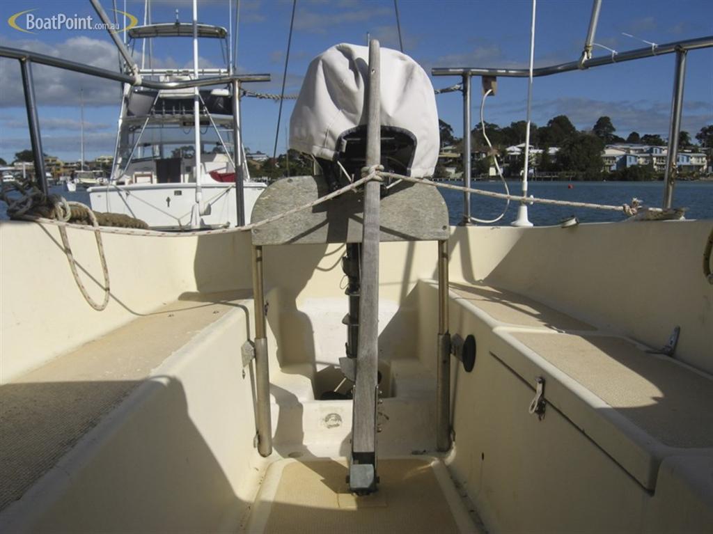

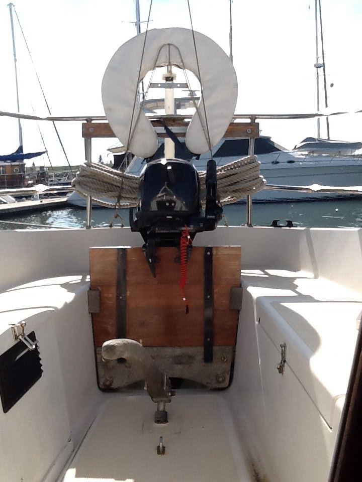

Outboard stowage.jpg (81.74 KiB) Viewed 11224 times
Diana, Firstly you are a youngster. Secondly brute force can be replaced by simple engineering. Take a look at the attached photos. They are typical of systems that lift the motor straight up for dry stowage. You can rig a lifting system from the backstay, or have a simple lifting frame made up with some pulleys, etc. The support system is removed, and the motor lowered into the normal position. As stated here before, if the exhaust relief is piped below water level, the noise and fumes of a well install are much reduced. Far better than transom mount!
