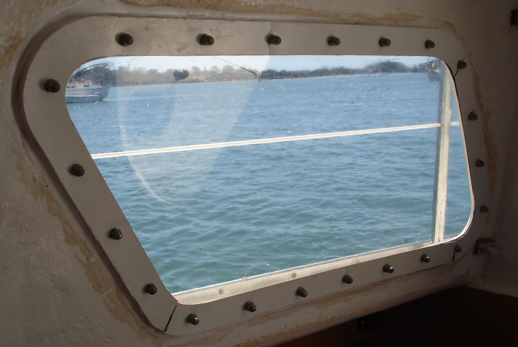

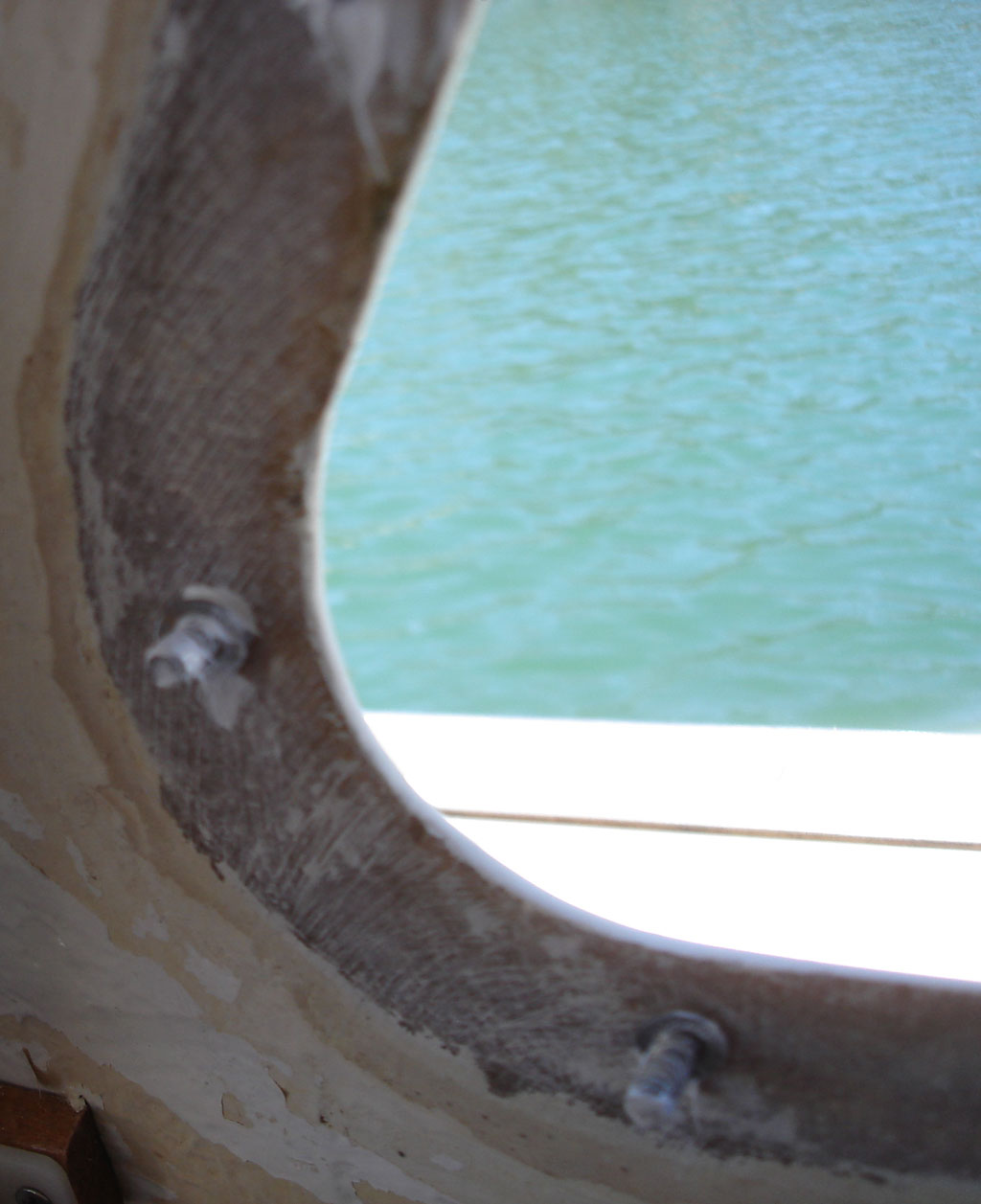

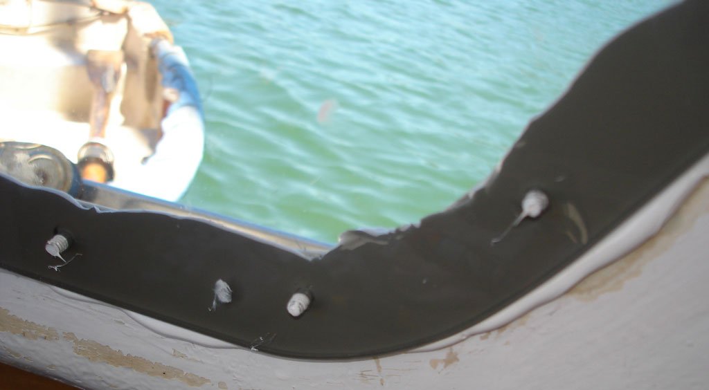

Postby Phillip » Wed Jul 16, 2014 10:25 pm
This a window done some time ago.
Even after all this it did leak recently but I just tightened up the bolts and all was OK :D
Window removed showing bolts. Note the extra washer as a spacer.
Window with sikaflex not cleaned up.
Completed window
