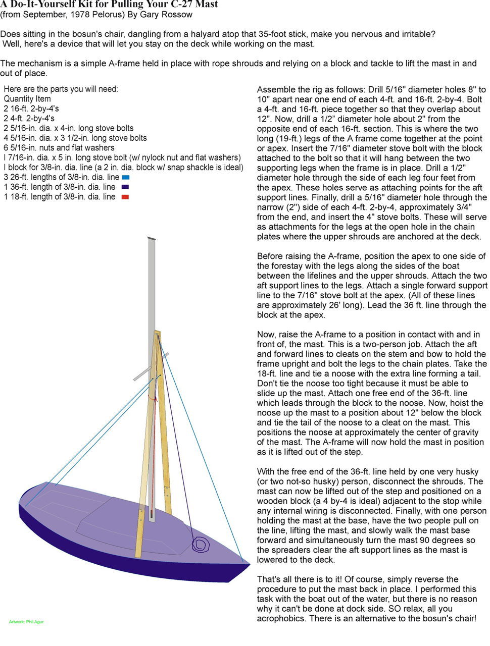

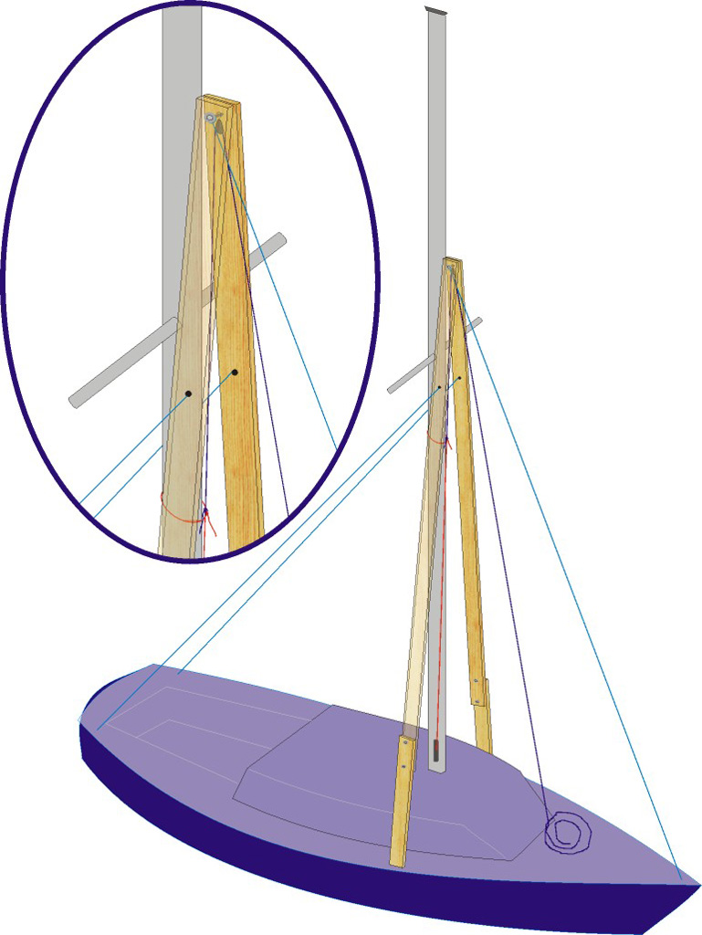

Postby Phillip » Thu Apr 25, 2013 4:05 pm
Found these two photos in my files.
May better explain how to do it yourself. :D
Mast raising instructions
Details mast raising
