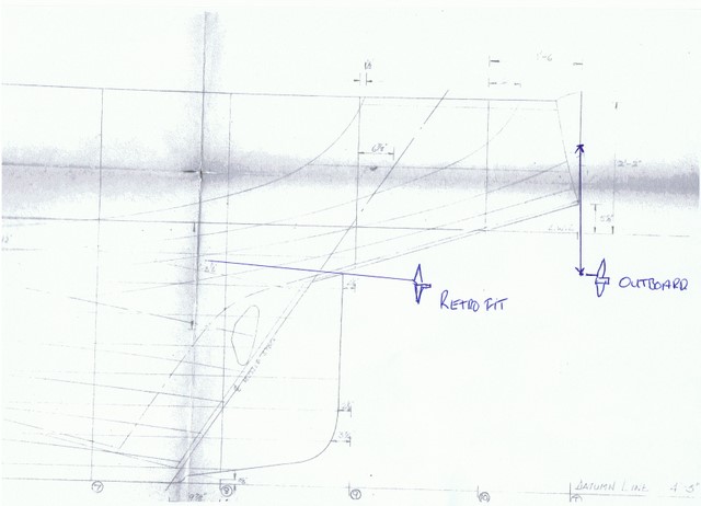

Looking at the pictures none of the examples given have the prop behind the rudder. Are all of these retro fitted? The drawings I've looked at show the prop behind the rudder. If that's the case it doesn't put the prop any deeper than the outboard in the well, and low speed manoeuvering will be no different. So that takes away a couple of the pluses I had in mind

Roughly worked out the difference in height of long shaft outboard and the 'retrofitted inboard ' most properly about 150mm difference ,but ? the retrofitted inboard is further under the yacht " yet an outboard in a well might be at the same height . Disadvantage ? hole in the cockpit floor ! NOTE: position of preferred prop by Illingworth and Primrose :D

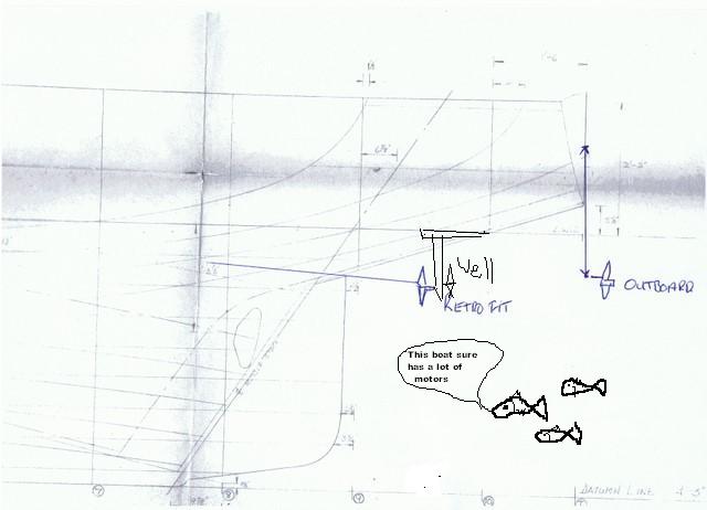

Yeah the outboard in the well is about the same as the retro-fit and the big hole allows the cockpit to drain super fast from poop. :idea: Whilst coming throgh the rip last Christmas the outboard prop was clear of the water and howling when she was coming off the back of some waves.
