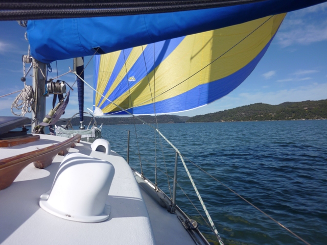

Postby TimothyH » Mon Aug 13, 2012 4:48 pm
Hello again Mark
Re sheet under bow, no problems yet; Doyle have sewn a clever little doohickey at the tack which juts out about 15cm, the lazy sheet sits on this - it looks like a narrow piece of batten sewn into a canvas sleeve- you can just see the white catcher to port of the tack.
Timothy
Lazy sheet catcher - stops it going under bow
TimothyH
Posts: 23
Re: Asymmetric kite
Postby storm petrel » Mon Aug 13, 2012 5:53 pm
Thanks Tim. That looks like a cleaver solution to the problem. I do not think my cheap sail has this, but I will take a closer look next time I go to the boat. I have not had a chance to use the new spinnaker yet.
