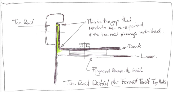

Below is a drawing of what Diana and Brian [here at Dunbogan] have been fixing.
It also shows the plywood core that needs to be replaced if it is wet or rotten!
Toe Rail Detail for Marks 2 & 3

Postby Killick69 » Thu Jun 21, 2012 8:42 am
Phillip, good drawing. How far does the ply run. Is it a core running all the way under the deck, or is it only in small sections where there is load, such as the stanchions?

Postby SeaLady » Thu Jun 21, 2012 10:08 am
I had ply underneath the triangle part of the stauntions on the deck. i.e. outside not inside (Although there are ply triangles on many nuts inside - i.e. visible on cabin roof. )
Surrounded and drowned in silicon over the years.
The ply was not visible until the stauntions had been removed. And were a surprise to the shipwright.
I think he is putting them back with epoxy but I will check and take photos.
From what I have been seeing this certainly seems to be a job for someone who knows what they are doing. Absolutely beyond my skills and my meagre attempts of just put on more Sikaflex exacerbated the problem rather than fixed it. More to clean off.

Postby Phillip » Thu Jun 21, 2012 5:09 pm
John, I will check with Brian tomorrow on how far the plywood sheet went, until then:-

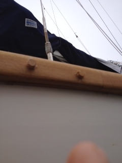

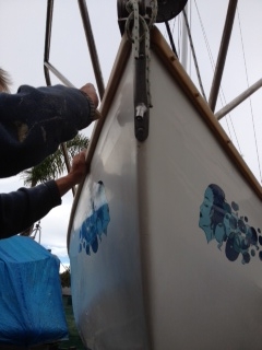

Here are photos of the toe rail from the bow showing smooth and also from the port side showing the new scarf joint and plugs not yet cut down.
This weekend the timber gets sanded, sealed and varnished.
bow with toerail being fitted.JPG (45.09 KiB) Viewed 8192 times

I can confirm that the plywood is only under where there are fixings through the deck!
