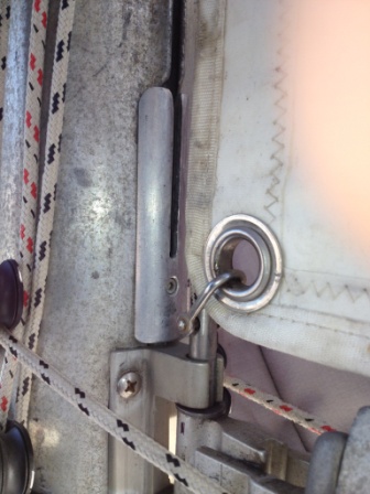

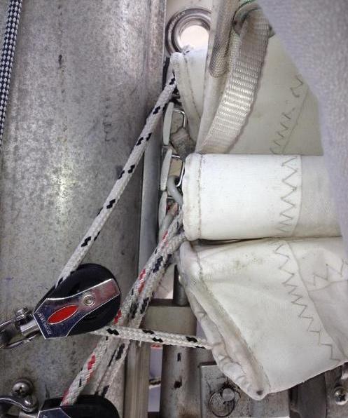

I had a third reef put in the main after getting caught in Bass Strait in 30 knots a few years ago.
Have found it very handy over 25 knots when used in conjunction with the storm jib and going to weather.
To save removing slugs I made up a fitting to retain them in the gate area.
Third reef.
Gate plate.jpg (62.66 KiB) Viewed 8605 times
