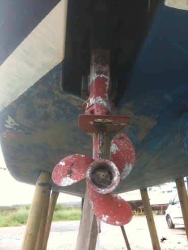

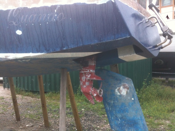

Postby rob.lovelace » Mon Nov 14, 2011 9:10 am
Okay I saw one on a thunderbird 26 that was out on the hard that had antifoul on the outboard leg and was left in the well. The guy was from Mornington where he has a swing mooring and says he has always done it. He said he puts a sacrifial anode on the leg though.

Postby PittwaterPirate » Tue Nov 15, 2011 8:55 pm
Do you recall the make of the outboard motor Rob ? It would make a great advertisement for the manufacturer !

Postby rob.lovelace » Tue Nov 22, 2011 6:01 am
Mercury
